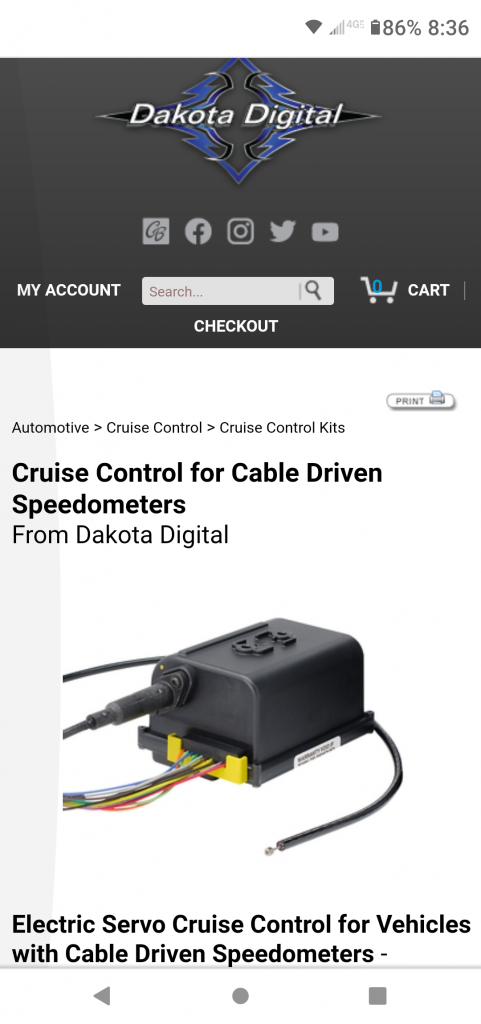

Rostra makes a very nice aftermarket cruise control setup. You can use the factory cruise lever to control it.
On my 81 GMC, I used the factory speed sensor. On my 69 ok, I had to use the Rostra speed sensor that goes inline with the speedo cable.
Both systems work very well

85
This. All their stuff is top notch.
