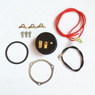

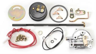

Isn't OP using an edelbrock? If so this is the kit you'll want to rebuild the electric choke. If OP is using the other carb disregard this post.
Side note: The edelbrock 1405 normally comes with a manual choke the 1406 has the electric choke, so the original owner looks to have swapped on the electric choke. Might want to go through it and make sure it was done correctly while your at it.
Yeah, they might have swapped it out. This oart sure is a lot more pricey, but if it's the only option I might need to just wait for a paycheck and then get it. Once I have it what do I hook it up to? the switch on the oil pressure just has a hose leading to the gauges themselves.

@jfrancom101 it sure looks like it'll fit the bill. Yours already has the rod and other bits so you should be good to go with that kit.
Grit dog also makes a good point about being able to go back to the manual choke but you'd have to convert that carb back to that. Probably need to get a kit or a at least a few parts to accomplish that.
On all of the edelbrocks I've had, the previous owners installed them but they've all sourced power from the ignition power source to the HEI distributor. The best way would probably be to run it from a different source so your not cutting/T'ing into your dizzy feed. Anywhere that has a keyed 12v is usable though.

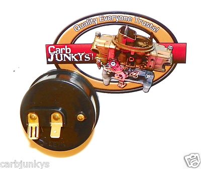

Would that brand actually work on my edelbrock you think?
Oh I forgot you had that, one second
Same cost generally it seems

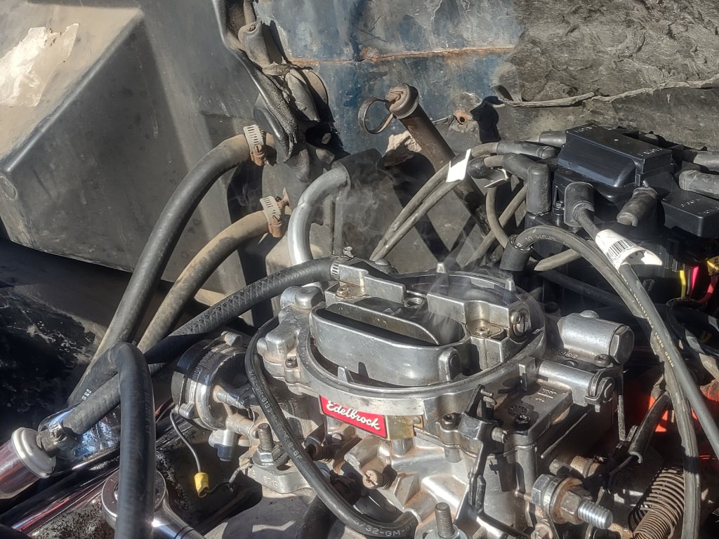

I'm still working on getting the electric choke figured out. I can't find the spring or where the spring goes to keep the choke shut when not engaged. But good news! The truck is 100% running on its own (after fixing fuel pump issues, and timing, it been a journey)
Today I started it and once I turned it off I didn't notice any backfire but smoke came from the carburetor once turned off.
My timing tool is a little old and might be a few degrees of so maybe that could be part of the problem? If it is a little too far advanced? I am still saving up for a proper air filter because the one that I have doesn't fit, that might also have something to do with it?

this is a 1406
maybe some thing helpful?

smoke could be condensation buildup if its not running fully yet to be dry.
