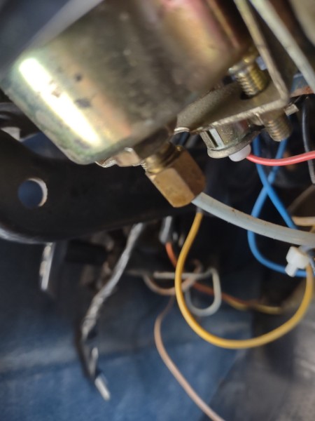

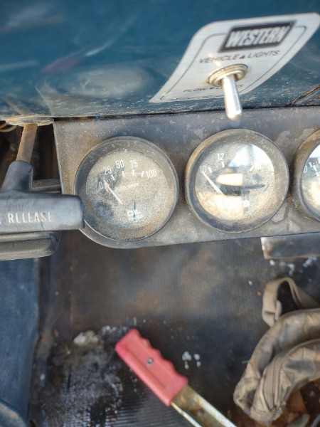

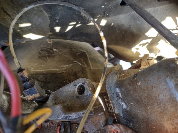

Ok so here's what I got. the oil pressure sensor isn't right on the block as shown in the pictures. its actually a little plastic hose that runs oil to the gauges. Not the original gauges, it looks like in the switch from diesel to the 5.7 maybe they had to redo some things like that... There was a small oil leak that leaked right onto the floor mat and I found where the wire was a little cracked to that explains the leak. Not sure how to go forward with the choke though...
