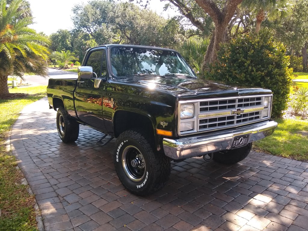

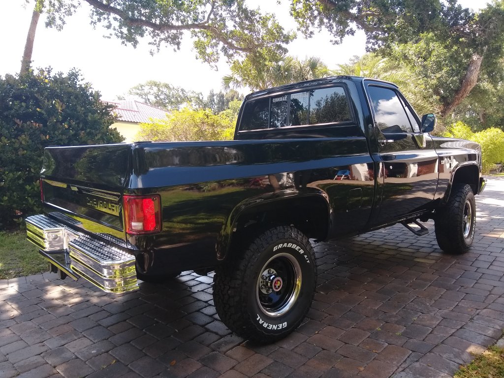

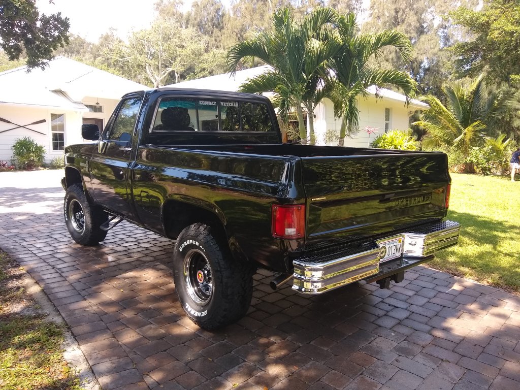

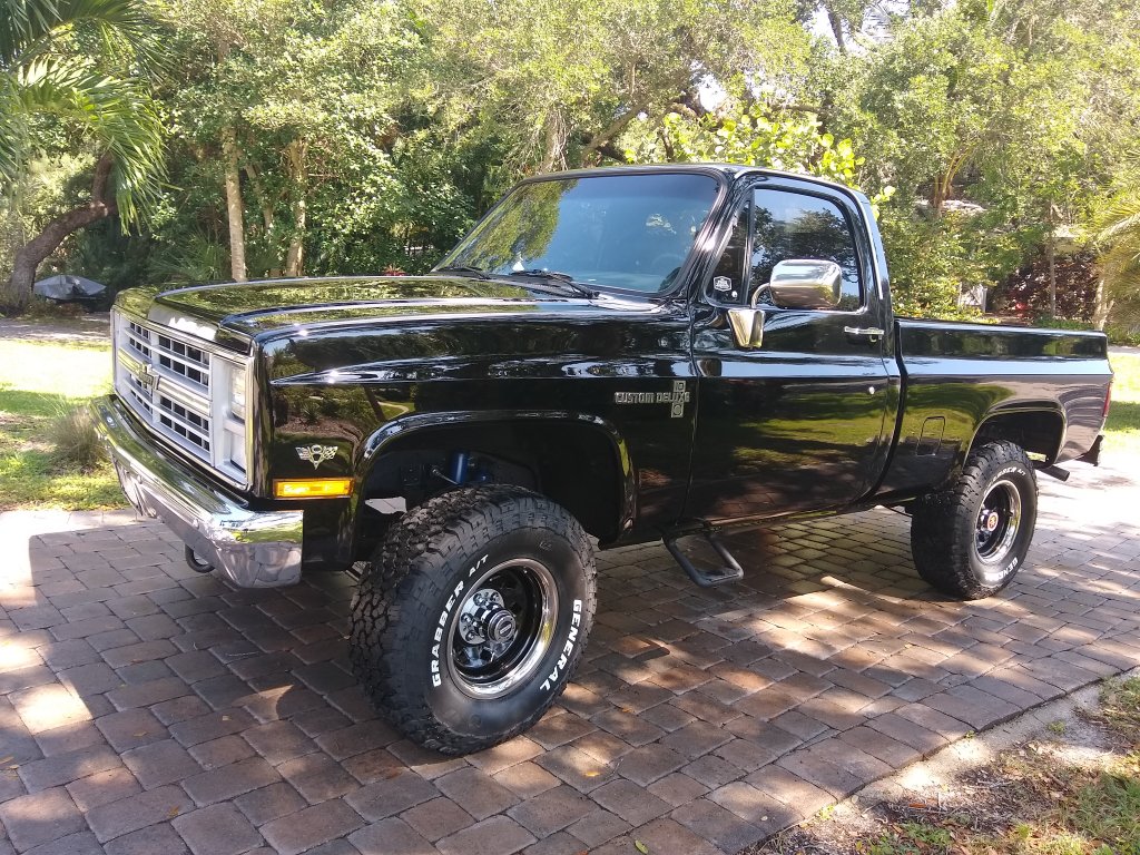

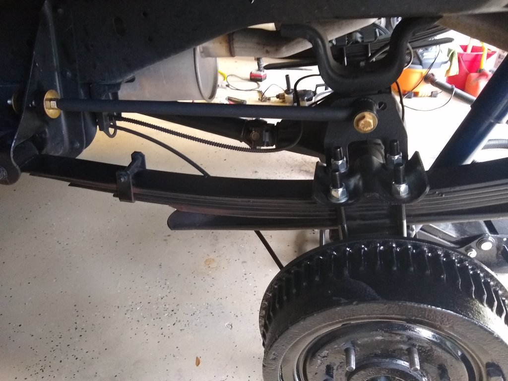

So a couple of weeks later and about $2k lighter in the bank account, it's done. Gladly, you can't tell anything was done from 10' away, but. New Skyjacker front springs, Off-road Designs sway bar disconnect, Tuff Country traction bars and the 4 degree shims. If a Square could ride like a Caddy I got it. Thanks for everyone's help in the decision making process.

I wish I could make my 84 K-10 ride that smooth.
Since I have trouble getting in and out of my trucks, they need to remain at stock height.
That truck rides so rough, I can drive over a dime in the road and tell if it's heads or tails up.

@Ron Sebastian the pics look great. I hope you got the stance you were looking for. My '87 doesn't ride like a Caddy but it does ride a LOT better with the softer Skyjacker front springs. It drives a lot better too. On a bumpy road I was having trouble keeping the tires on the surface, it was so stiff the tires were not keeping contact with the road.
I am glad I was able to help just a little bit. Your truck looks great.
