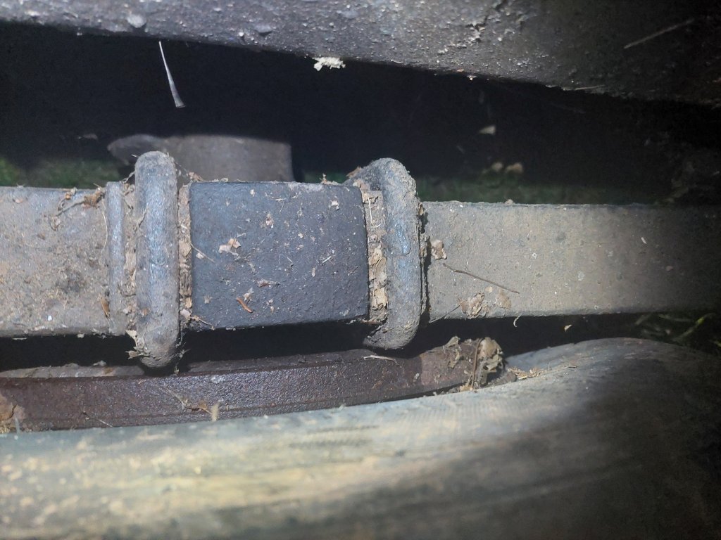

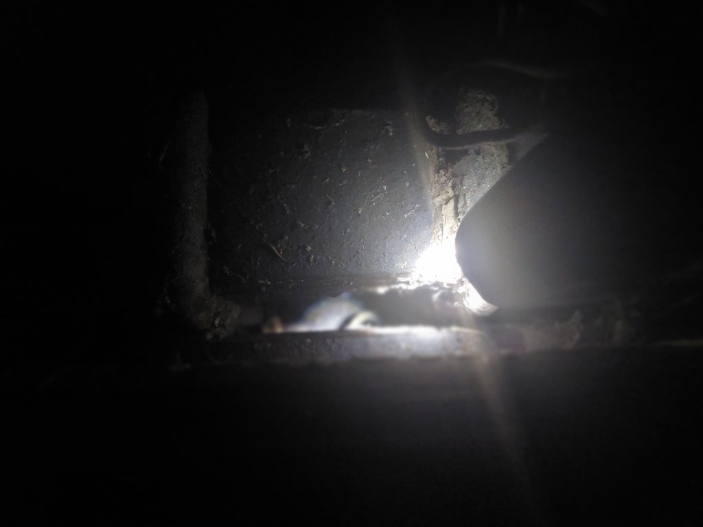

I need to change out the rear wheel cylinder on my 76 C30 dump. It appears that the leaf springs are set wider on the dump truck than on a regular bed, so I can't really get to the back side of the backing plate easily. I was planning to just drop the whole rear end assembly, as I just replaced all the U Bolts, so they would come off easily. However, after thinking about it some, could I pull the axle and hub, and then remove the backing plate to provide access to remove the wheel cylinder? I'm not sure what would be more difficult, just removing the whole rear end or the backing plate. Since it's a dump bed, I have access to everything pretty easily, and have access to a loader to basically lift the frame& bed off of the rear, once I have unbolted it. It just seems like a lot of work, just to replace the wheel cylinder. The springs are right snug up to the back of the backing plate, so I'm going to need to do something, as there is no chance of getting a socket in there, even just a wrench is going to be tight.
Just looking for ideas from anyone who has tackled this before.
Thanks

Thanks for the info and welcome. Yeah, I get that the axles and drum has to come off. Once those are off, can I pull the backing plate off as well? That would provide me better access to the bolts and brake line on the backside of the backing plate.
