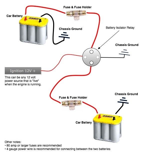

As my truck is a "Camper Special", I'm installing a second battery. Tray is in and a "so-so" battery is in as well.
I would like to be able to charge both batteries, however I wish to isolate the Aux. battery output from the main battery. I was told to get a battery isolator.
I've seen 3 post isolators for $180.00. (Really? It's just a freaking diode)
So, my question is for those who have been down this road.
What isolator did you folks use?
