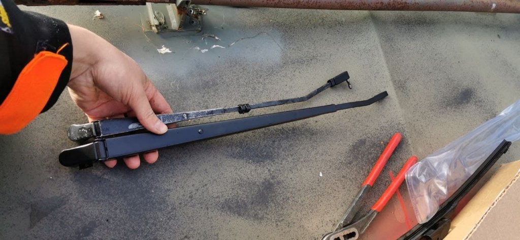

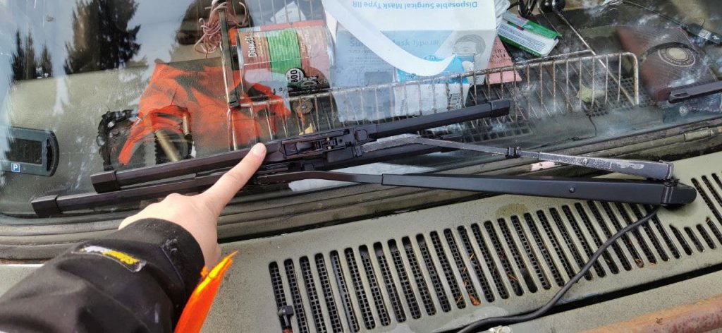

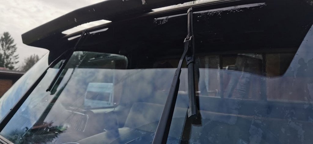

The Dorman 42580 I got from Rockauto are a tip up and will stay about 90 degrees off the glass. The tab you are talking about is meant for ease of install/uninstall of the arm.
But they are a garbage replacement for 1986 K10.
They are too long, 17" wipers will hit the top seal and leaves a huge unwiped area below.
The stud where the arm mounts is wrong size. At a first glance it might look like it wipes good but tipping the arms up, they just freely rotate and fall off. I bet they would spin with even slight resistance from snow too. I would not recommended them at all.
The blade in all pictures is Trico Ice 17". They seem to fit very securely on the stock pin type arms.
Do you mean the splines are not large enough, or are yours worn on the stub/stud on the truck? If the distance difference is mininmal, NOT Medium strength(so low strength) or that sleeve retainer thread locker would maybe keep it snug? Or if someone didnt mind a little modification, possibly putting a Hard Pin or fastener through the center if they could shore up the slack.. but they would need a hard hardness so it doesnt fatigue break and also be certain there isnt room for it to rock and wear out the stud and careful to have a small clearance for this pin or fastener... etc... i wouldnt do it to a new wiper transmission and setup for sure. Sometimes those studs get rounded from loose or high torque on frozen stuck arms etc etc.. The reason I say all this is carefully reducing the size of those arms with a vice, one could almost shorten and roll a new J hook that is just a tad shorter to bring it closer to length, then if the arm quality from dorman is the issue and not the arm design, then find the OEM application and replicate work on a new or good used one of those. I presume a jeep of some kind, maybe?
also that tab I thought was for locking the arm off the glass and then also removal since it doesnt let the arm pop up off because it rides in the machined in part under the splines so it just doesnt pull off, it would retain it that way, doing double duty basically. I dont know why it would lock the arm upward position if it wasnt also meant for that i guess?Pushing on wouldnt be hard without it doing that, unless maybe when new the springs would fight pushing on???
