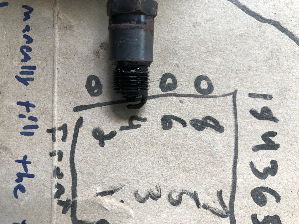

I pulled all the plugs cylinder 6 , 4 looked to be coverd in oil
Cylinder 3 had some build up of carbon. The rest looked good. Do i need a ring job?

What’s y’all’s take oil fouled?
