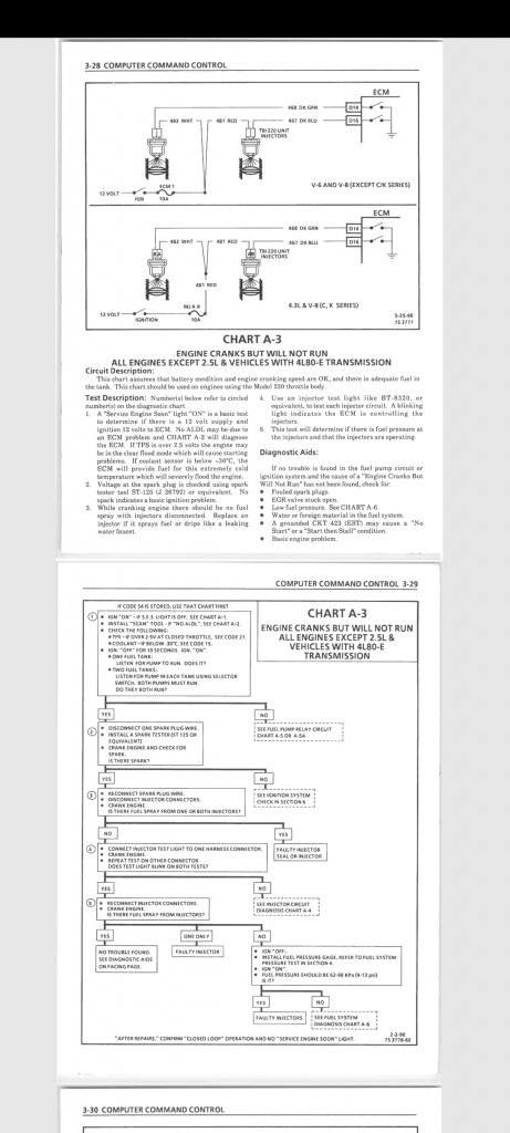

I'd start here and see where it takes you. the manuals are in the Reference Library.
