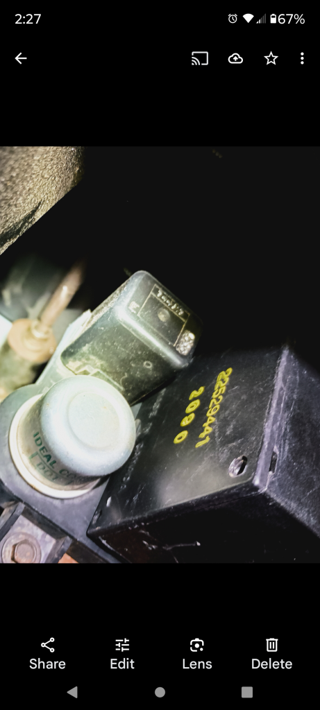

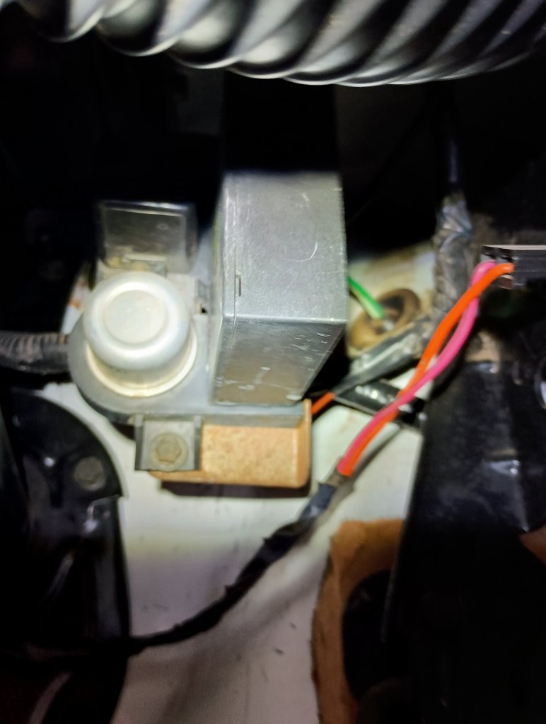

A guy on another forum said he pulled several buzzer modules from the junkyard and was selling them for $40. These are the OEM buzzers for our trucks if optioned with them. My Custom Deluxe has no buzzer. However, I'm told all trucks have the receptacle. There should be 7 pins. Depending which buzzer you get, it may only have 5 or 6 but the one with 7 male pins has all the buzzer options ( key in ignition, headlight, seatbelt, etc.) As I have now killed my battery twice in the past year, I wanted a buzzer for the lights. Well, I plugged the module in and wow, like magic, I have a warning buzzer for the key and lights!
Just posting this for those that may not know like I didn't. That plug is over near the gas pedal, has nothing to do with the fuse block.
And BTW, it's a nice soft buzzer, not obnoxious like the cheesy aftermarket ones you have to wire in.
