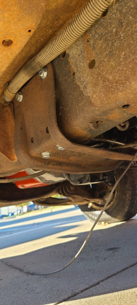

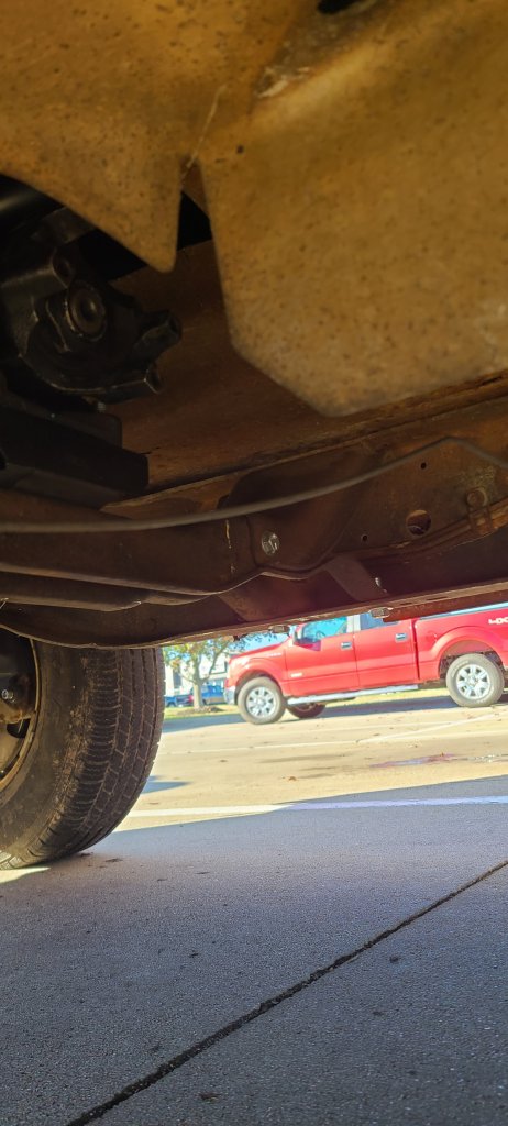

I took some pictures of it today so I could make sure we were thinking about the same thing. So is this what yall are kind of talking about as far as mounting positions? I put it back it the same as it came out so I didn't think anything should have been different.
31,884
32,658
Yep, that's all good there.
