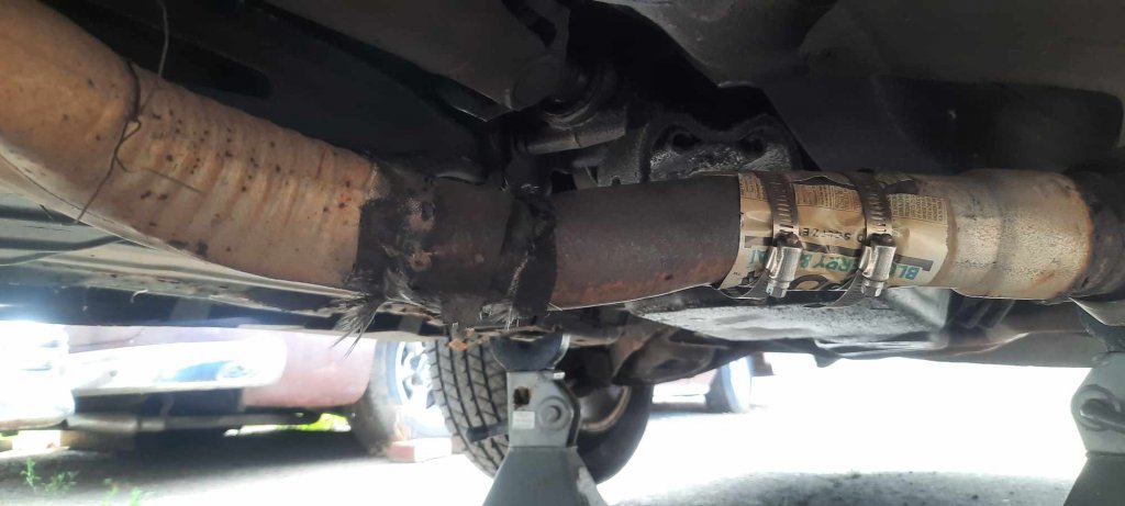

Yesterday we put the car up in the air to start on the fresh exhaust for it.
What came on the car is just a pile of crap.
I knew this after getting it home and looking under the car the first time myself.
Here we are behind the front passenger tire.
The Y pipe looks to be in decent enough condition, so we are going to be removing everything from there back as it is all crap.
You can see the spot where they attempted to weld onto the OG exhaust pipe and the random cut they made and abandoned.
It was welded so well that all it took to remove the cat off the pipe was a bit of wiggling and a solid pull.
Popped right off...
This is just after the cat that had been installed by a PO.
On the right you see it has a reducer from the cat to the exhaust pipe.
Under the soda can and hose clamps is some fine JB Weld plugging a hole where it looks like a hanger broke away.
The center dark pipe is some random piece that was put in to connect to the parts store crinkle bend pipe that goes to the rear.
That connection was very poorly welded and it was covered in exhaust wrap, but the gasses still blew out of all the pinholes...
That fine crinkle cut French fry pipe looks to have been installed quite low by the finely qualified installer.
It seems to have met many speed bumps to help it fit the shape of the bottom of the car just that much better.
Note the lack of rusted parts on the bottom of this 32 year old car...
