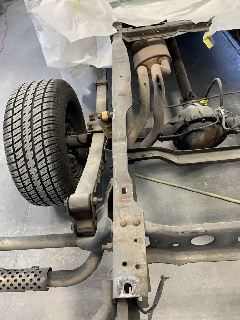

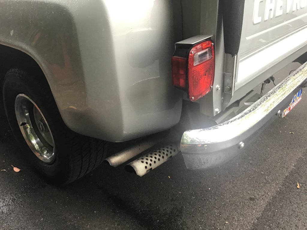

Thanks for the info, not a lot of glide out carriers out there. Also I have twin tip exhaust that exits behind the left fender on the Stepside, is that unique to the glide-out carrier? Not much room for a reciever
Might you have a picture?

31,376
31,129
Oh wow! That's cool!
Dual tailpipes were an option, but I guess original stepsides got that heat shield thing too? I don't remember seeing that before, but in Ohio original exhausts rotted out after just a few years.

Even in California, looking at pictures it’s hard to find
Thinking it might be unique to the carrier
I've seen the factory dual tailpipe setup before, I believe it was available with a standard tire carrier too. But that heat shield, it looks like it may be there to keep you from burning your leg, since that's an open area on a stepside truck.
