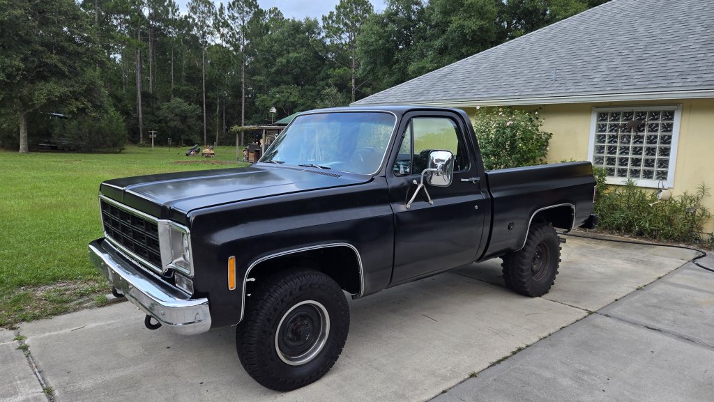

I just got my Brother Michael's 1977 K10 Scottsdale. Total Rebuild. Engine Starts, Runs and Drives Forward and reverse. High and Low transfer works fine.
Transmission does not shift gears.
It was working before the rebuild and checking for a Diagnostics solution if a connection could be the issue. Any thoughts or suggestions to help get this beauty back on the road. Thanks
