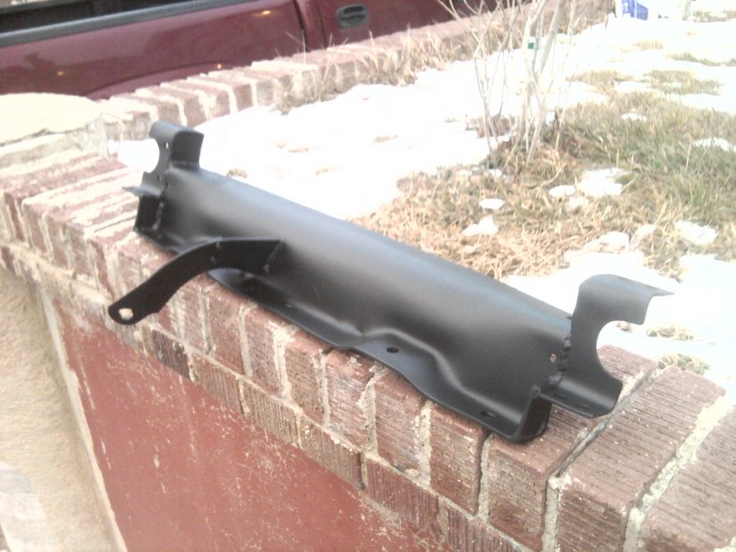

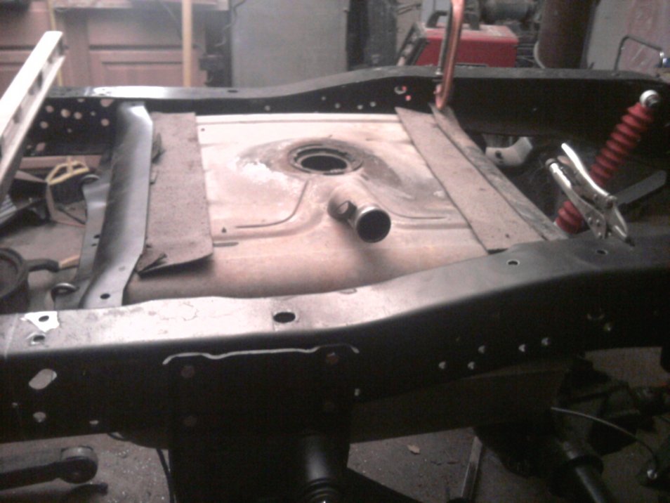

I used blazer x members to put the blazer tank in my crew cab
I had to modify the front one a little. basically I cut the ends off moved them up 2'' and welded them back on and braced them
the truck frame steps up over the rear axle where the blazer one is straight that's why I had to modify the x member
worked really well used stock blazer x members straps and tank
