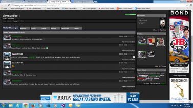

Ok so I don't know if I just don't know what im doing but I did not find anything that says anything about an album. Here is what my screen looks like. there is nothing else above or below the edges of the screen.
