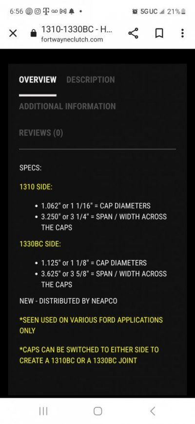

Recently my 13 year old son acquired a 85 C10 on a K20 4x4 frame from a family member as a project and first vehicle. We are getting it fixed up pretty good without to many problems, but the one main issue were having is locating the proper ujoint for the rear u-joint connecting to the diff. I'm guessing it's a 1310 to 1330 Big Cap, but I can't find one with inside clips on the big cap! Any suggestions?! It had one on there before! Attached is a pic of the dimensions that I need.

You should double check my recommendation,
Spicer 5-134X

Close, but I need inside retaining clips.

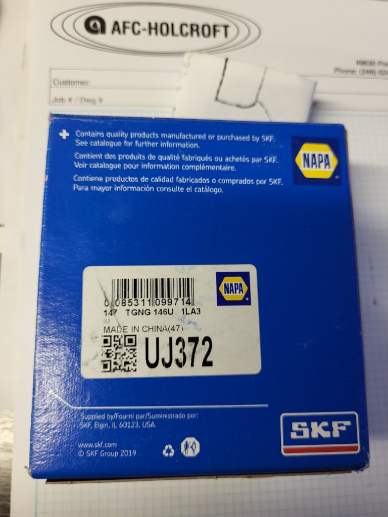

I did find the correct one at Napa. P/N UJ372, in case anyone else needs the info.
