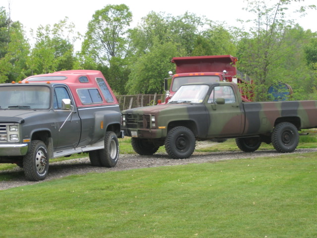

None.
If you just want to go slighter taller get some 255/85-16's.
These don't hit and fill the wheel wells nicely.
