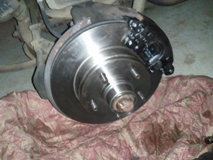

Finally got around to replacing my sticking caliper and ruined rotor. Still low on brake pressure though. Going for the MC this weekend.

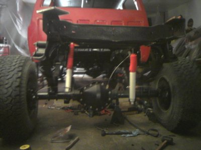

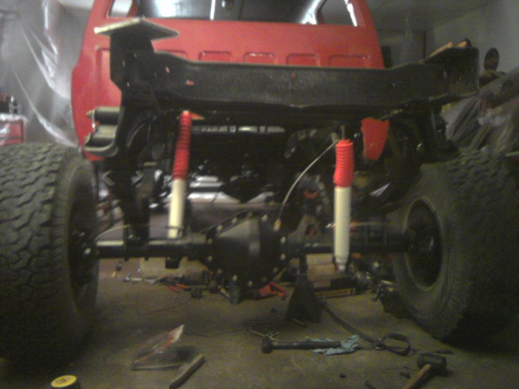

i finally got my 6'' rear springs cleaned and painted and loosely put them in my crew cab.
i ordered new teflon pads and got the wrong ones now i am waiting for the correct ones to get here. thats why i loosely put the springs in my truck i still need to take them back apart for the teflon pads
