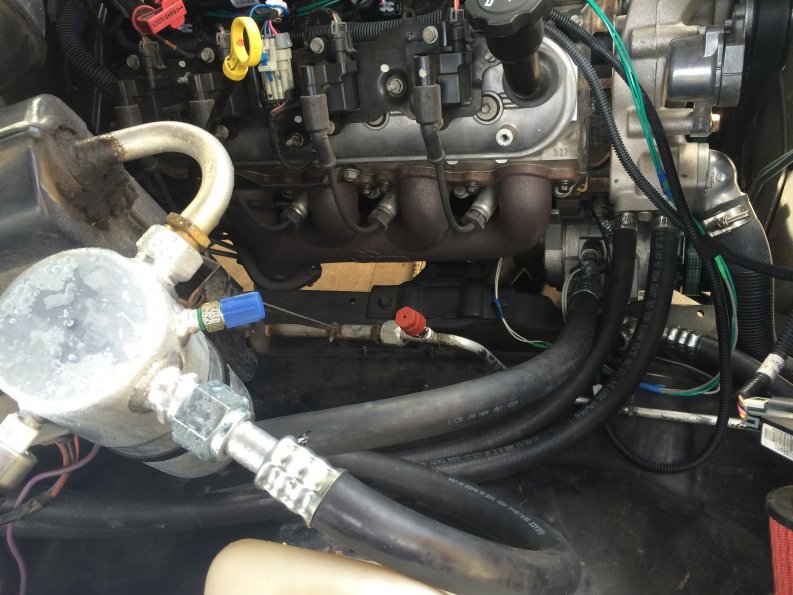

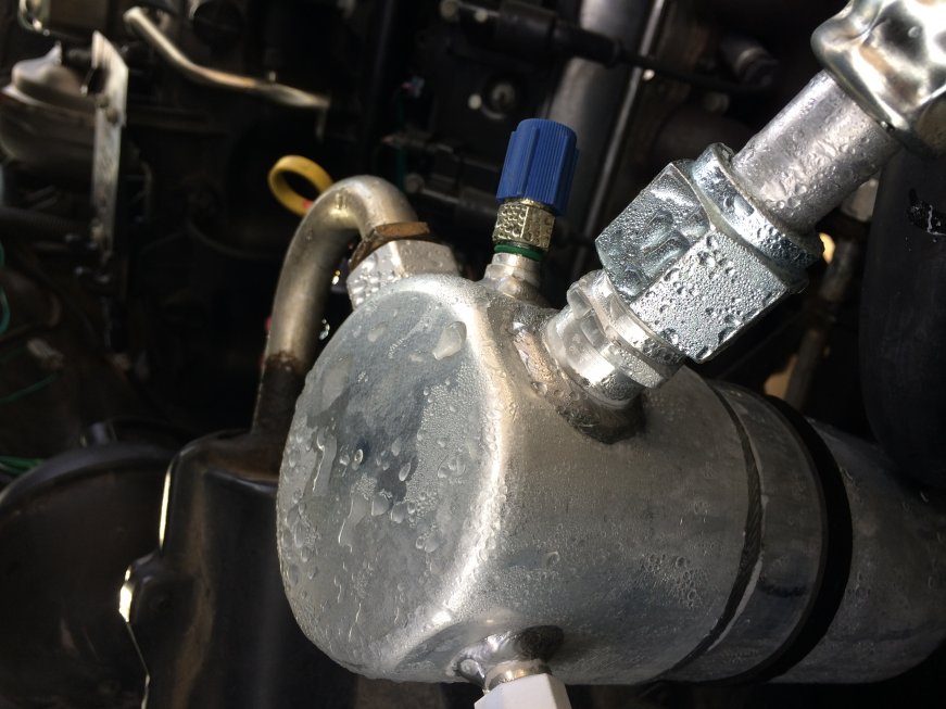

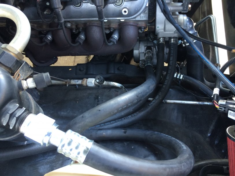

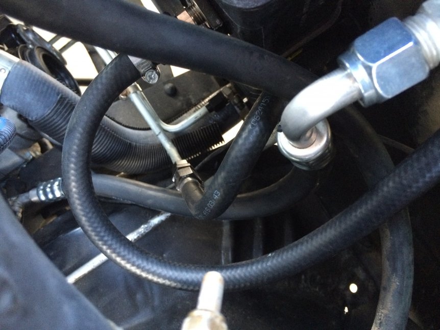

Haven't look at the geometry or the hoses. When I go to do the LS swap, is it bolt on compatible? My compressor is low passenger side if i remember correctly. I don't have AC on the 350 I have currently so doing it when the LS swap is done is at the bottom of the list.
I used a factory low mount compressor (Denso 10S17F) with the Tejas Steelworks mounts. You might be able to position the engine with some Dirty Dingo sliders to where you can use the factory low mount compressor, but I'm not 100% sure on that. I did have to notch the frame to clear the A/C hoses from the compressor.
I used the factory compressor hoses. I took them to a shop and had them weld on new barb fittings and crimp new hose and hose ends to mate up to the Squarebody A/C stuff. I bought an ACDelco replacement parallel flow condenser for a 91' Blazer (PN 156960). This required some minor tweaking to mount, but wasn't difficult at all.
Wiring will depend on your harness. I have a blue/green PCM that takes a serial request, so none of the A/C clutch engagement is handled by the PCM, since I have no way to send an A/C on serial request to it. What the PCM will do, however, is read a pressure transducer in the high side line from the compressor, and control the fans based on the pressure. I used a BP Automotive harness, and they had the wiring for the pressure transducer built into the harness. Since the PCM doesn't control the clutch, you need to make sure you run a high pressure cut switch to shut off the compressor in event of high pressure (blocked condenser, failed fan, etc). The new Denso 10S17F I bought came with one. It will cut power to my A/C clutch relay when the system hits 455 psi on the high side.
I filled the system with 8 oz of PAG 46, and the shop that charged it put 2 lbs of R134a in it (best vent temps at this charge). At 2 lbs, it cools nicely and the accumulator is sweating, indicating a complete charge. This is only a baseline, every setup will differ somewhat, depending on hoses, condenser size, etc.

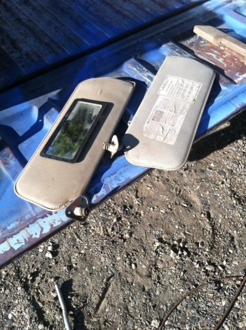

Painted and installed both sunvisors and arm rests I picked up from "You pull it". Pulled the small bezel that covers the gauges and painted the backside white. What a difference! While I had the lens off I used a 3M restoration kit to clean it. It's too far gone to be perfectly clear but there is some improvement.
