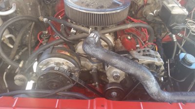

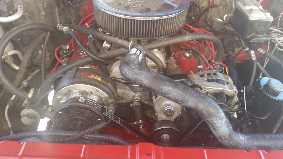

water pump went south.. put serpentine on
Well my water pump crapped out finally It was about 7 to
8 years old.. i had gotten a serpentine set up off my brother inlaw 5 to 6 months ago or so and i planned on putting it on this summer but looked like now was the time to just go ahead and do it. The setup was off a 92 sub 2500 454 it had everything on it is needed and got it for free so why not. I was hesitant to try it but i took off all the old acc and bolted it all up before i went and got the rev pump. It all worked so i got it put it all on and seems to be working fine. Never did figure how to rotate pics on here.. sorry

So you bought a reverse rotation water pump right?

Yes i got the reverse pump. The belt i got was to long and man did that thing squeal. Had to go down in size almost acouple inches to try to split the hash marks on the tentioner pully. Buy the way i hear if you cant getem to stop squealing to use a good year gatorback belt. summit sells them couldent find one at any parts stores
