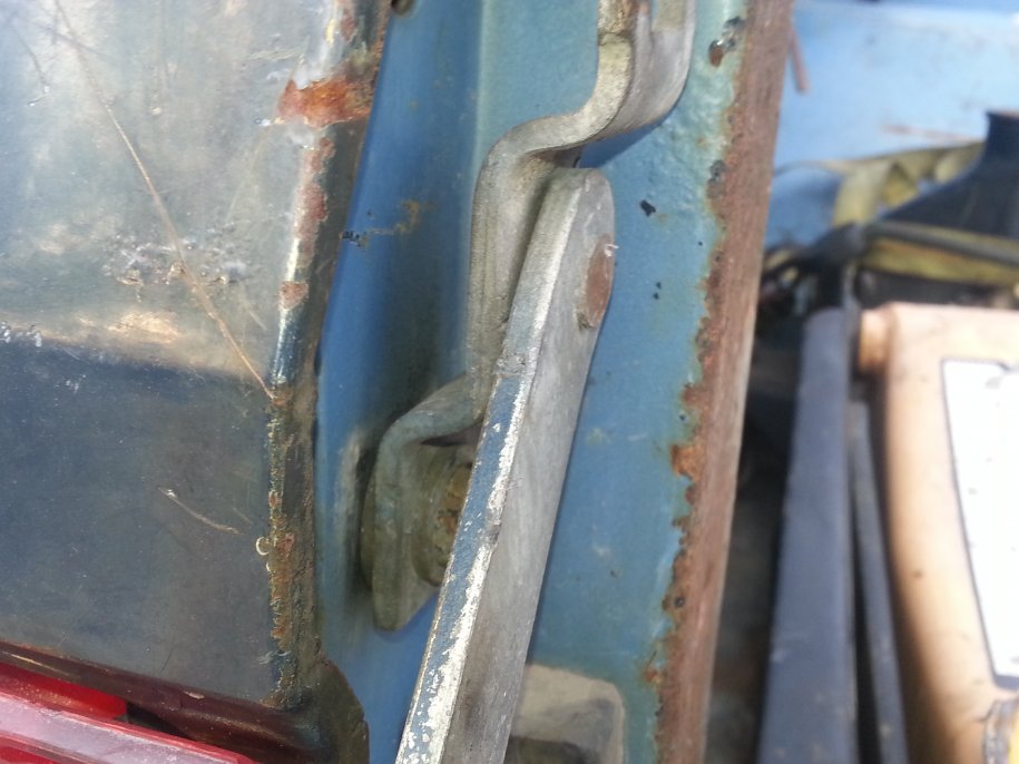

Tore the internals out of the tailgate, brass brushed off rust causing it to seize, replaced the main rivet on handle arm with a nut and bolt with some rtv to keep the nut in place. Greased all the contact points and springs on each end of the arms. Put washers behind then latch bracket to get a stronger latch.

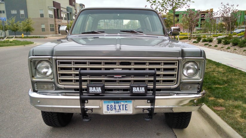

New bull bar and fog lights. 55W don't pump much light but they look cool.
