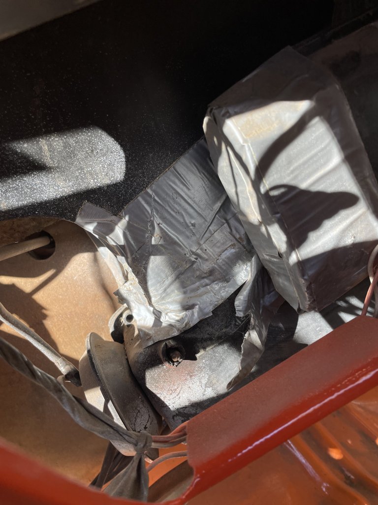

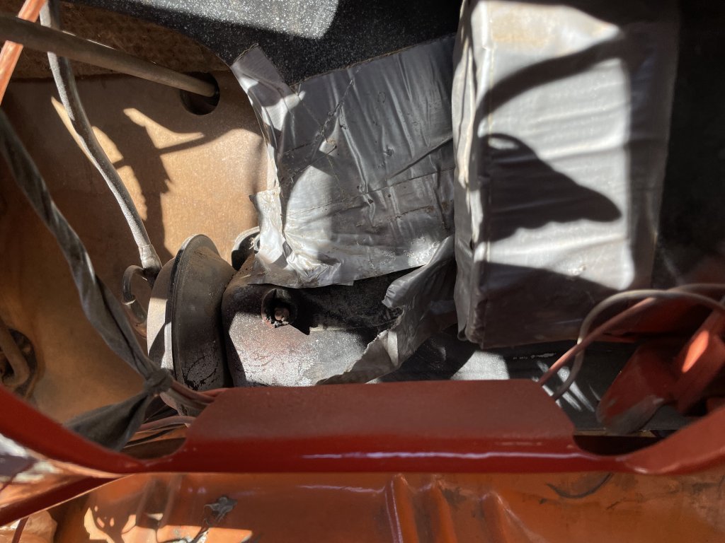

Lightly sanded the hood epoxy primer, thin layer of filler, then sanded that mostly smooth. While I was waiting for the filler to harden, I removed some of the heater distribution vents to determine what’s missing and needs repair. The box itself is a little loose so gonna have to tighten the blind nuts on the firewall, missing the left vent tube, missing seals, and looks like PO trimmed a little too much on one vent, and used 200 mph tape rather than repair it properly. Probably gonna take an hour or two to make it right.

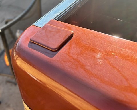

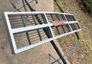

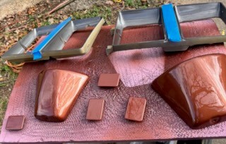

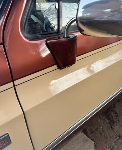

Painted my mirror covers and some stake pocket covers from Truxedo. Spray can basecoat from AutomotiveTouchup.com, and SprayMax 2K clear from Amazon. Also cleaned up and clear coated my unobtainium 1983 GMC grill.

Okay,... Start sharing your magic or stop shaming us mere mortals.
Your call.

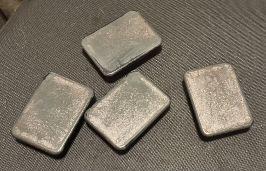

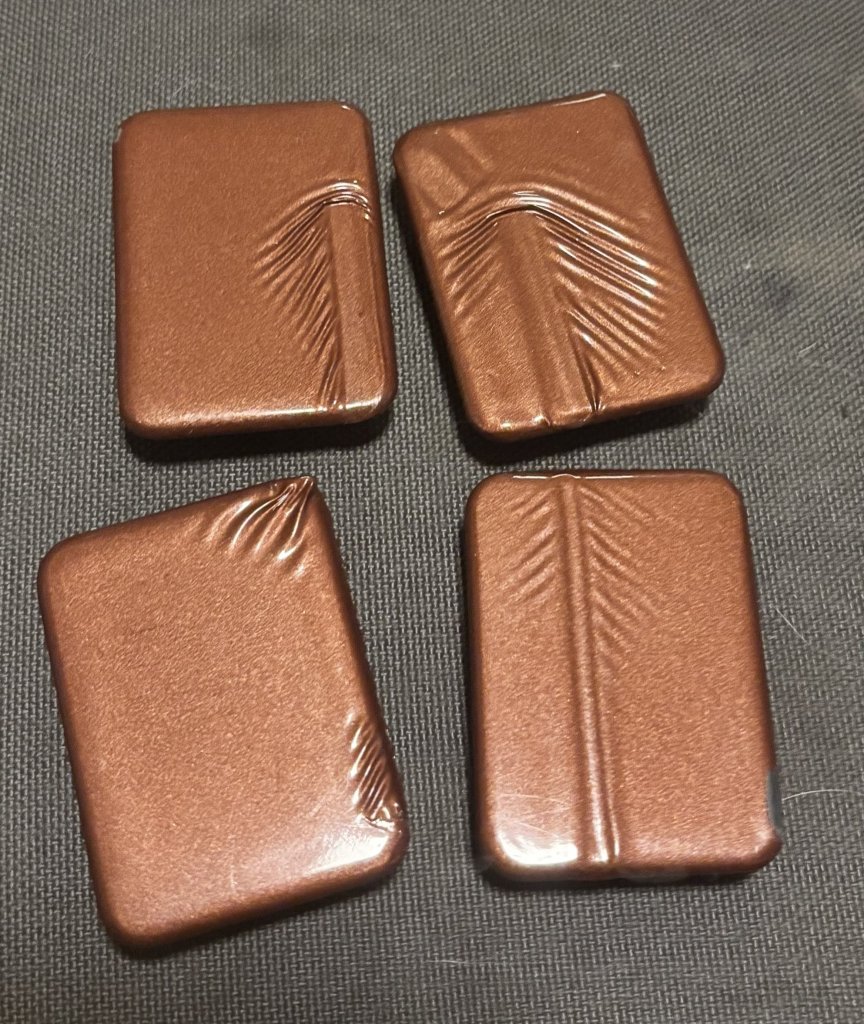

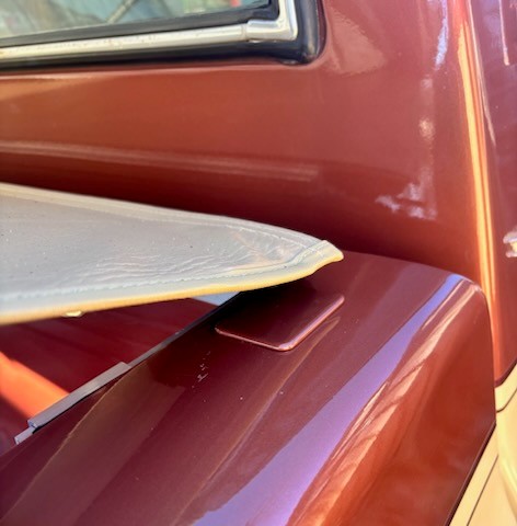

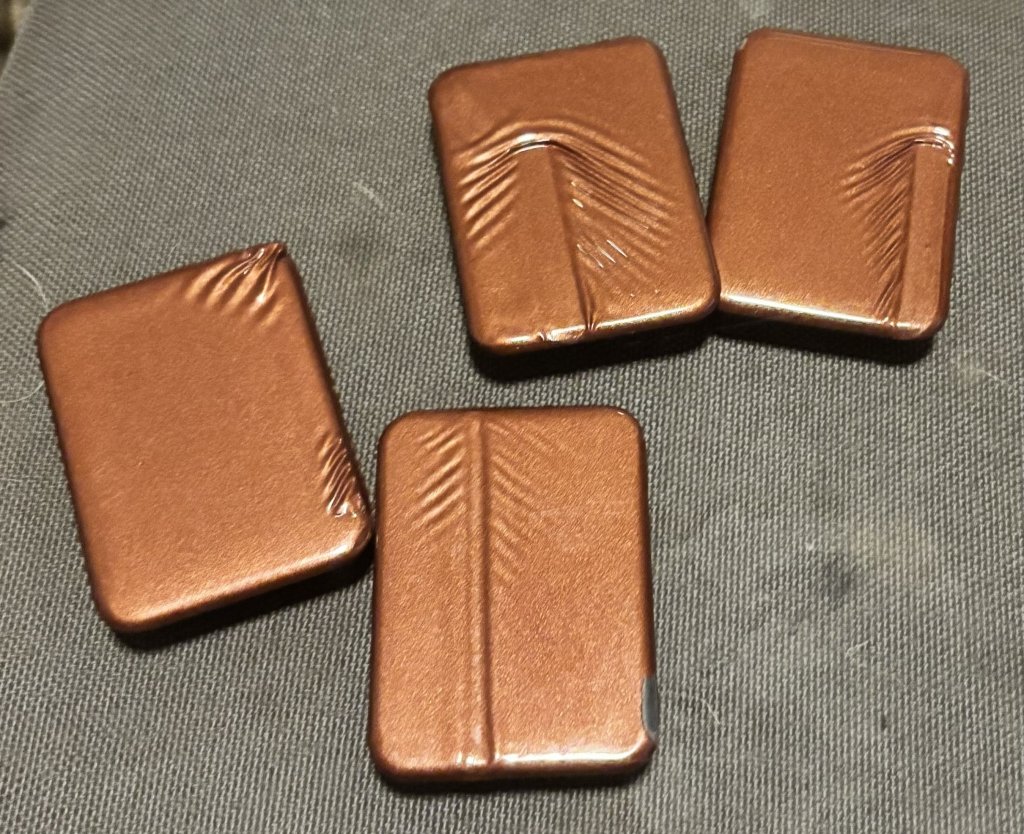

no magic. i didn’t tell you it took 4 times painting them. Waiting two weeks before putting them on. Then they still weren’t fully cured and then yesterday this happened from the tonneau cover. Stripped them all the way down,now using an adhesion promoter, and repainting again today.
