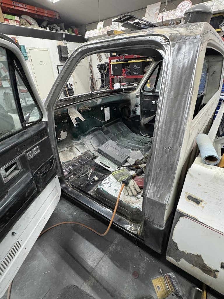

Think I may of Killed the old 90° die grinder with 2” pads cleaning the door jam/ b pillar, just trying to push through the lack of motivation this weekend.
