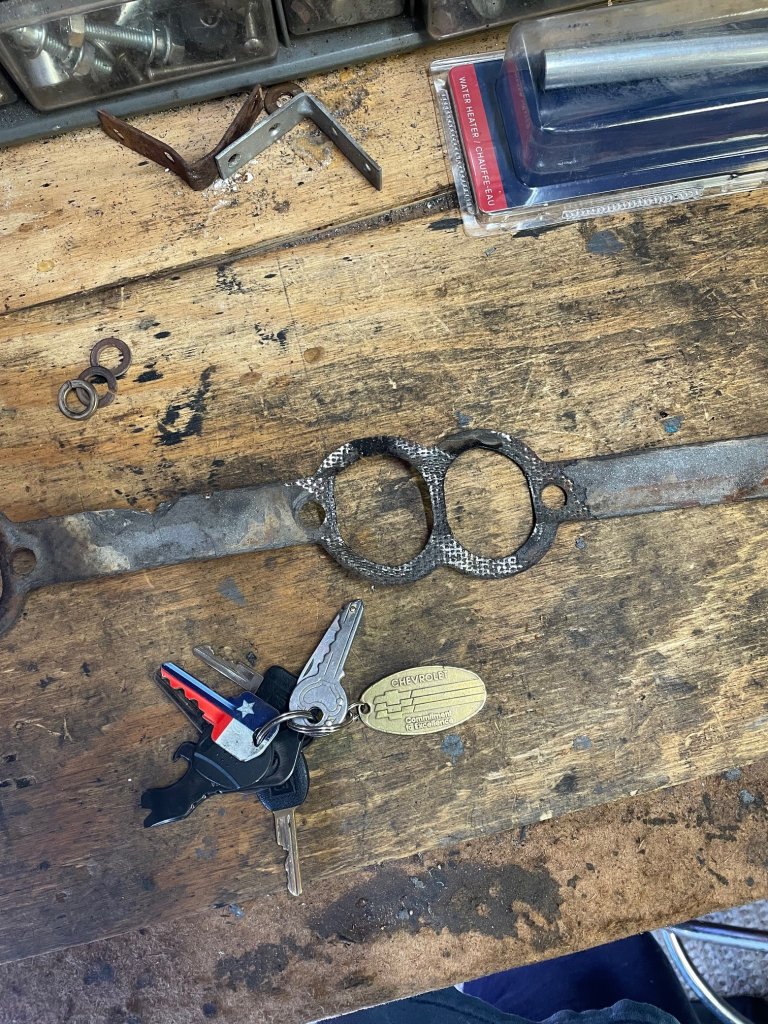

Replaced the driver's side header gasket. It had been bad for a while. The truck sounds so much better now.
