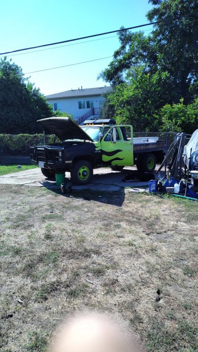

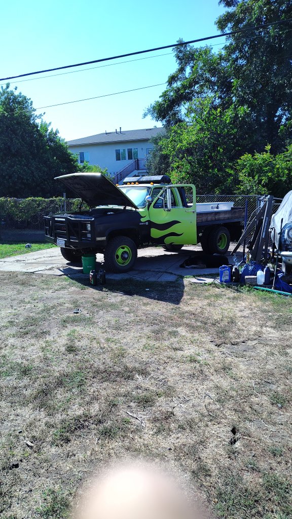

Decided to do the coolant drain and fill I only have the diff and t case fluids left then she'll be all caught up on maintenance for a bit next will be the body and suspension bushings then I can finish up the metal work
