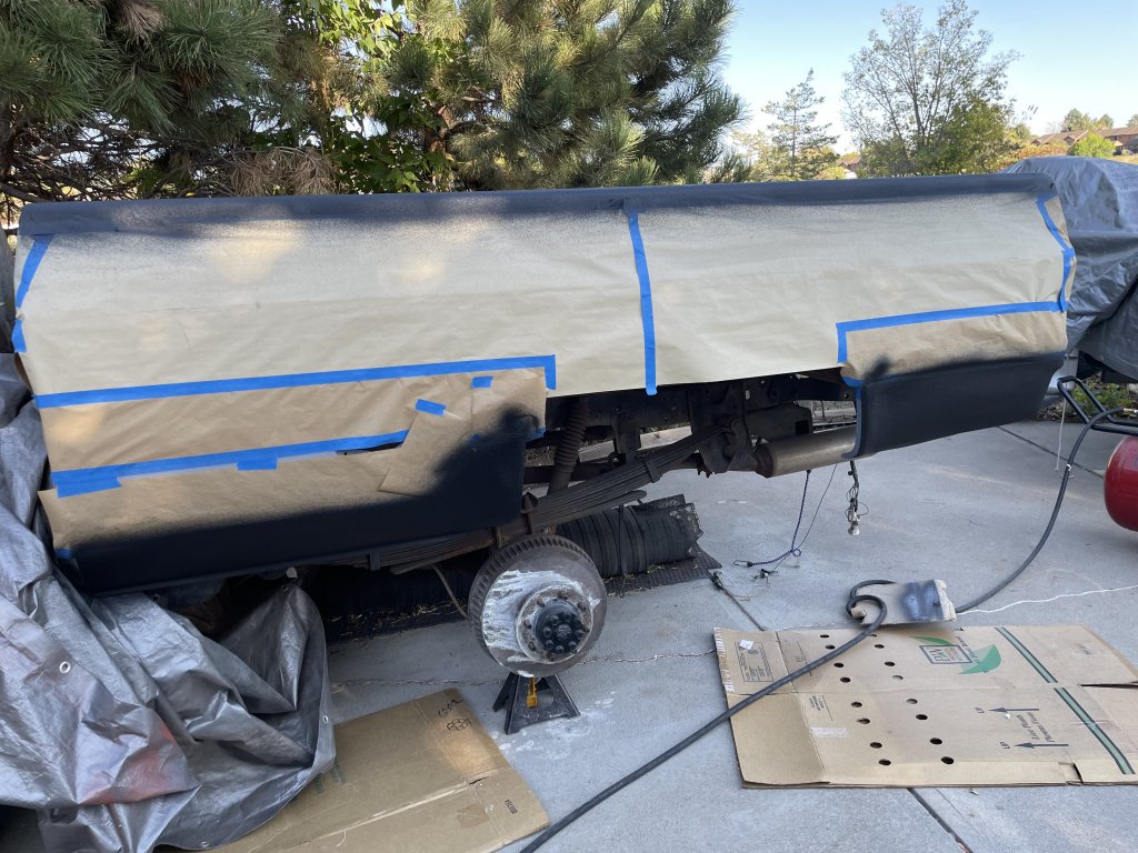

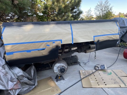

Paper and taped the box sides, washed the bed metal down the with soap and water; assuming no wind, I plan to shoot primer and bed liner tomorrow morning. Let it dry a couple days so I can put it to work to haul some landscaping materials.

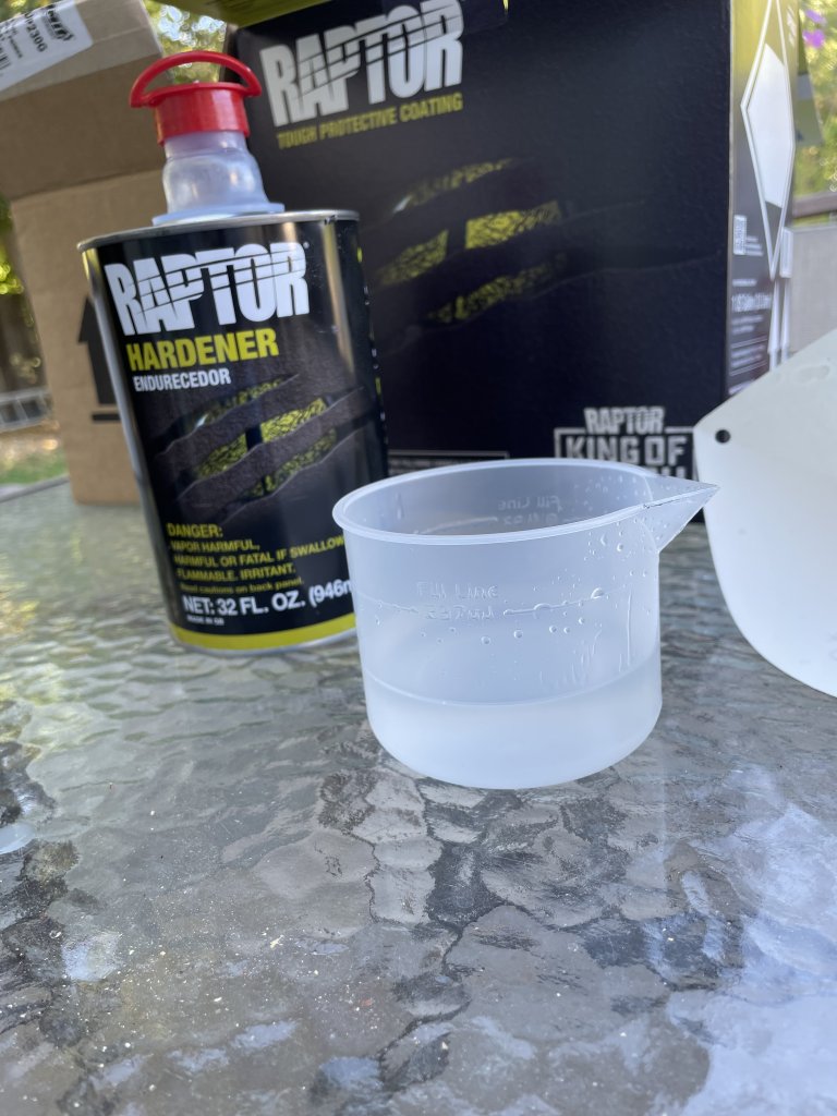

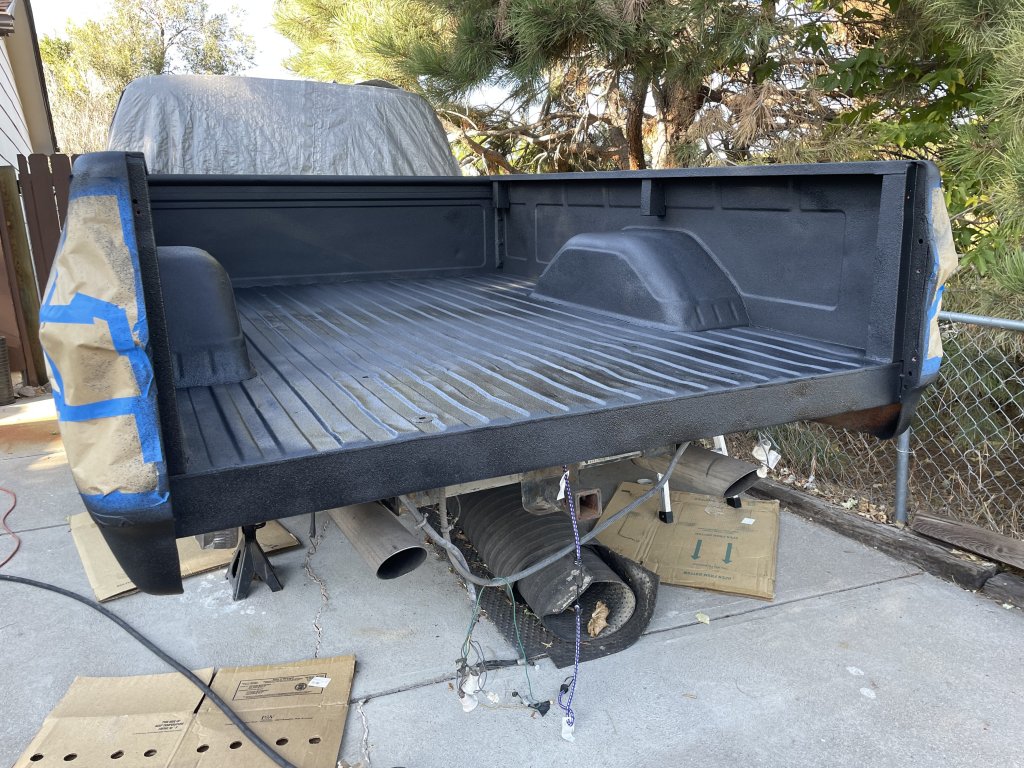

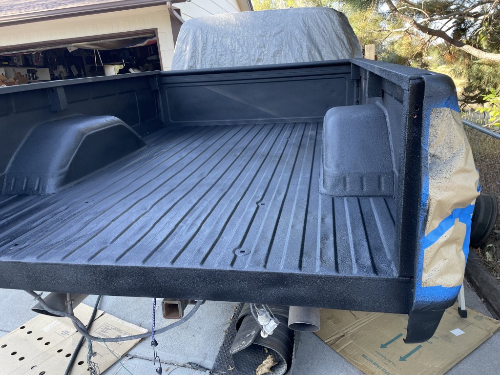

1.25 gallons of Raptor liner and around 0.25 gallons of epoxy primer. I’m sure some of you are cringing that I sprayed it for chip guard on the bed side. It was that or lots of hammering, filling and sanding….. I chose the easy path, I will be spraying gloss white over it as soon as it is cured. I got jipped on the hardener, less 4 ounces.

Badass!
No hating on spray in bedliner. I would have done it too, but repainting it was quicker and “free”. Already had enough leftover paint supplies.
