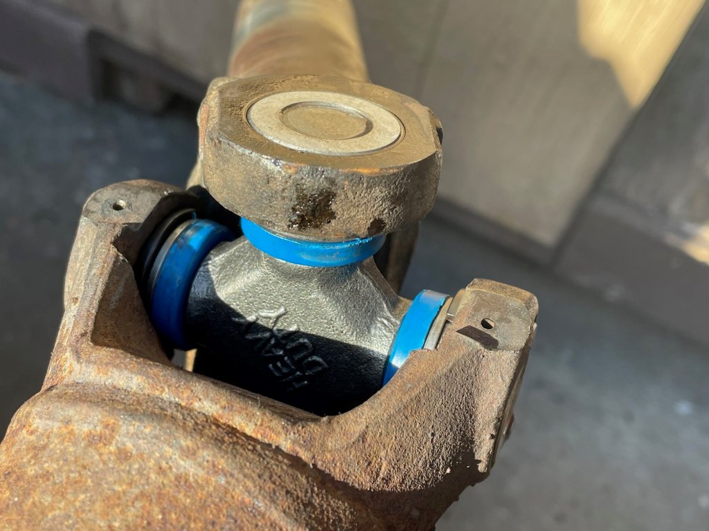

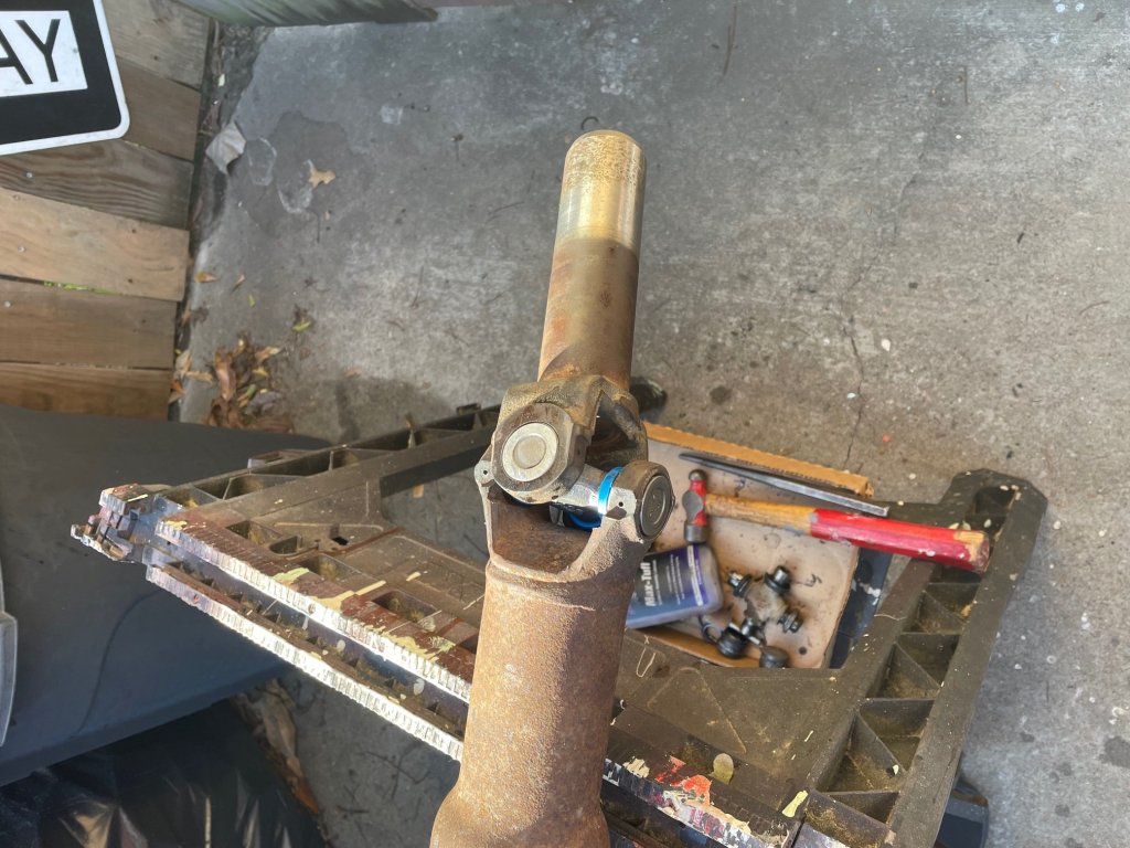

Replaced the rear driveshaft U-joints. I had to melt out the plastic locks from the old ones. I'm thinking they were from 85.:oops:
I have the one-piece shaft. I used the C-clamp from My Maddax ball joint kit and a Dewalt impact to remove and install the joints. There was still grease in the old ones. Now on to the front shaft.

I like the original u-joints. They last a lot longer than joints you have to grease every so often. Why people like joints they need to grease is beyond me.
