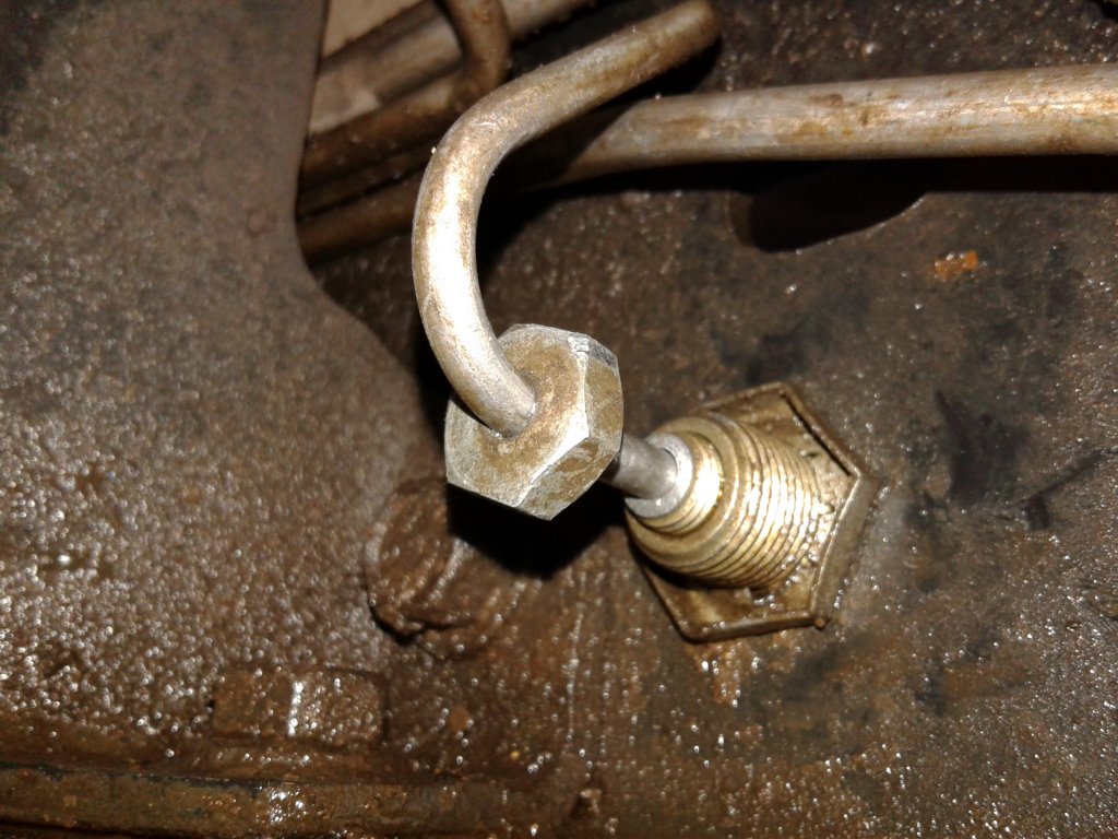

Had to unhang the brakes again today - apparently it was not the master cylinder causing that but the proportional valve.
Which means the new AC Delco master cylinder earlier this month was just more practice.
:confused:
The pedal literally hung on me at a stop sign this morning- I had to undo the nuts holding the master cylinder to the booster.
Once I got far enough off the booster I heard a bang and felt the front of the truck shake as the valve released.
Hasn't done it again all day, and I had done a good gravity bleed on all 4 last Sunday. Maybe I flushed some crud loose - who knows.
@Flatwater - I would not rule out that prop valve on yours.
The only replacement I know of, though, is Chinesium off the internet- Fleabay or Amortizeon...
I think I went with the latter but due to 5 flare fittings have not installed it yet.
Those fittings, especially on this truck, scare me. o_O
Best of luck.

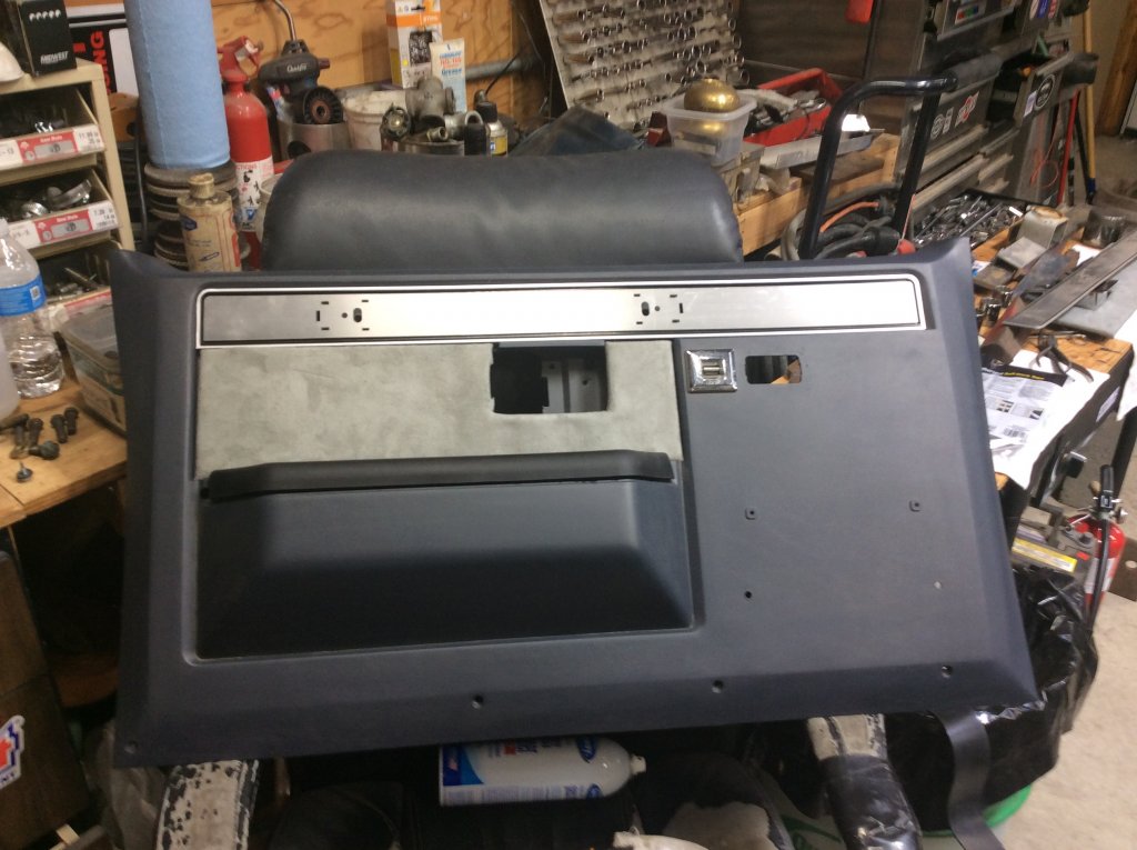

getting it together,slowly!! painted the door panels a charcoal gray,then a light gray suede on the inserts!! The floor mat turned out pretty good too!!
Coming along nicely. Door panels look sweet. Is your truck a twin to mine too? Interior looks the same.
