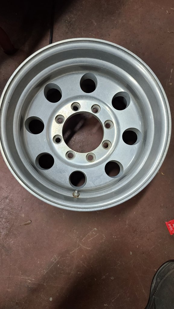

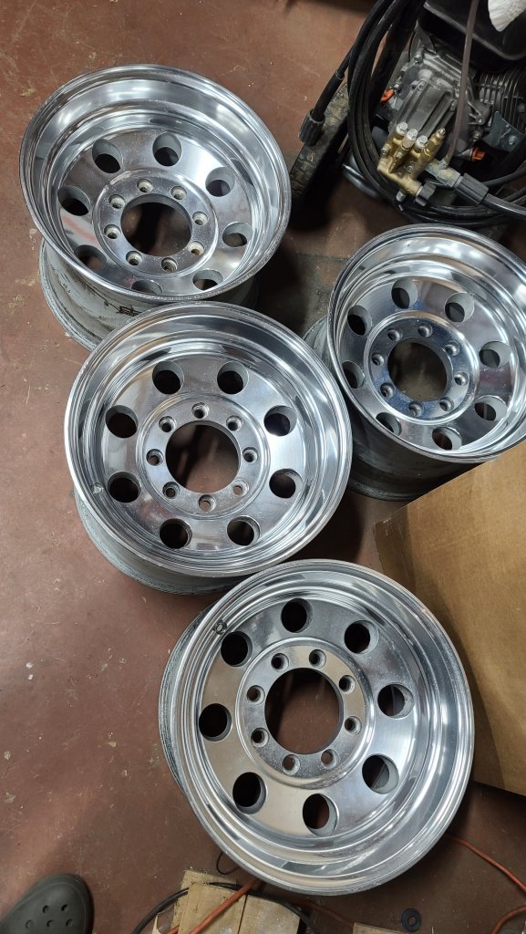

I don't post much here, usually just in my build thread, but had to post this here. I have not cleaned or polished these wheels in 20 years. My buddy told me about this polish, and wheel cleaner. Holy crap. Took me about two hours. The best part was, it didn't take and power anything. It was all done by hand. A little before and after.
Looks good!
I don't suppose you'd like to share the name of this miracle product, would you?

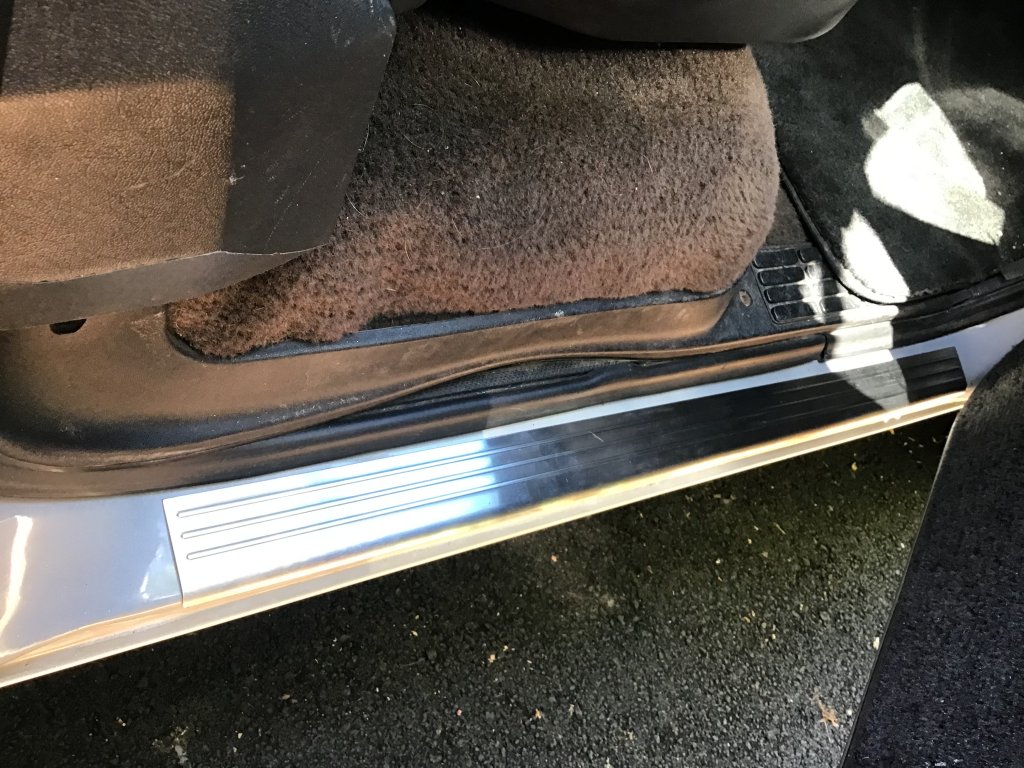

Stainless steel sill guards
