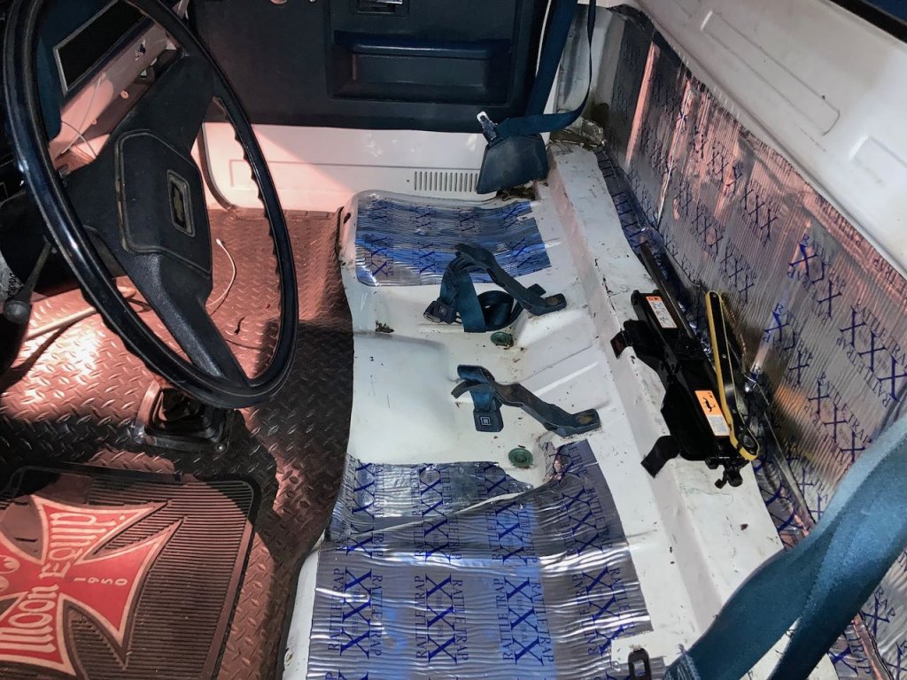

While I'm waiting for the seat to come back, I had this on the shelf.. Generic Dynamat works as good as the original, and after years and years, It may in fact come off if you wish. quieter already!

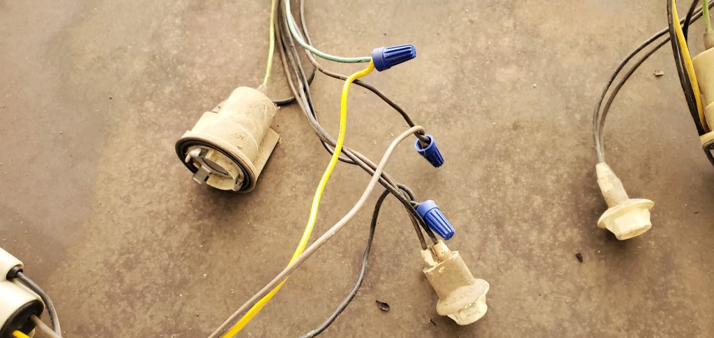

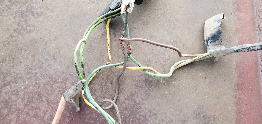

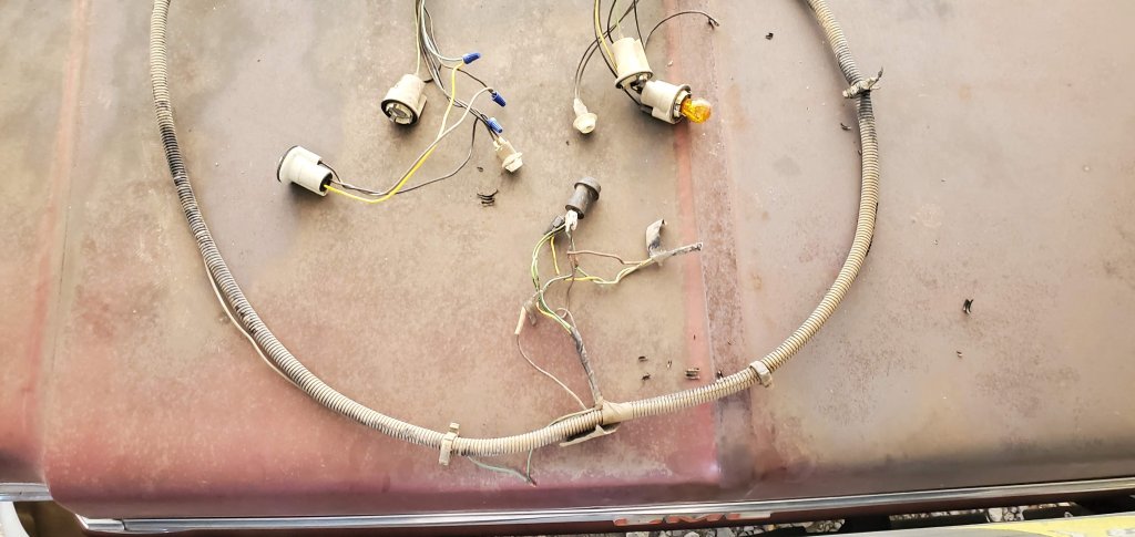

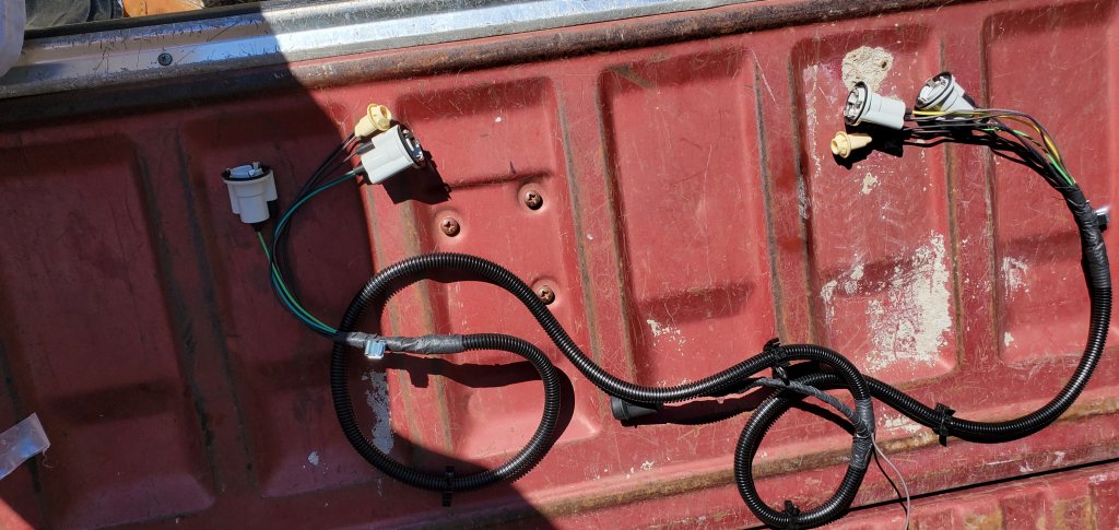

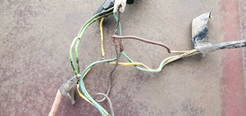

I replaced the rear wiring harness today. Note the Home Depot twist connectors and dry rotted electrical tape that I found on the old one. Also fixed a speedo cable leak and changed out the transmission fluid and filter.

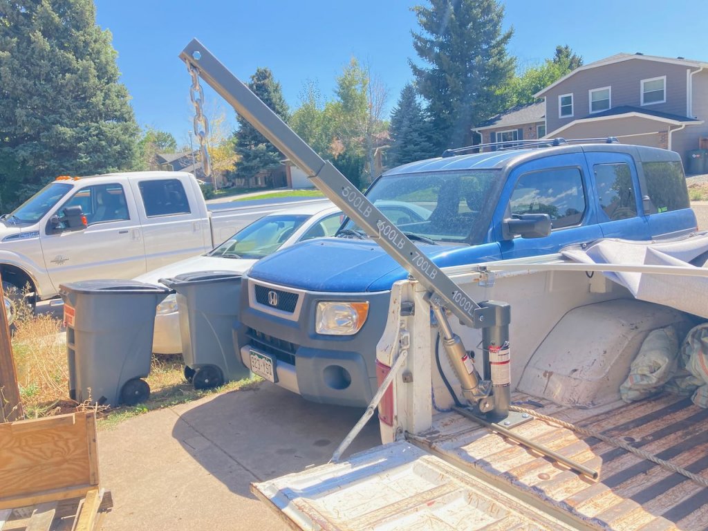

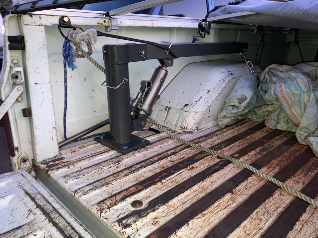

A Crane! This was a good addition to my pickup. Use it only occasionally, mostly for moving engines. I bought this cheap harper frought crane and bolted it into the bed. Handy. No issues, it does what its supposed to do. Removing the tailgate is easy if needed, but not mandatory. Also, I use a jack under the rear bumper to hold the truck up when lifting as the weight of a load can drop the truck before it lifts the load.
