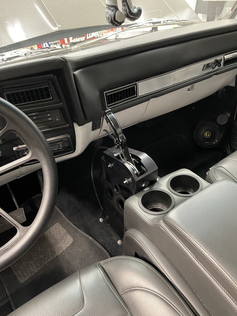

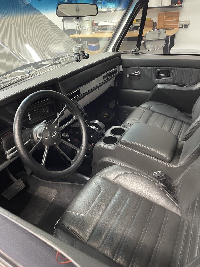

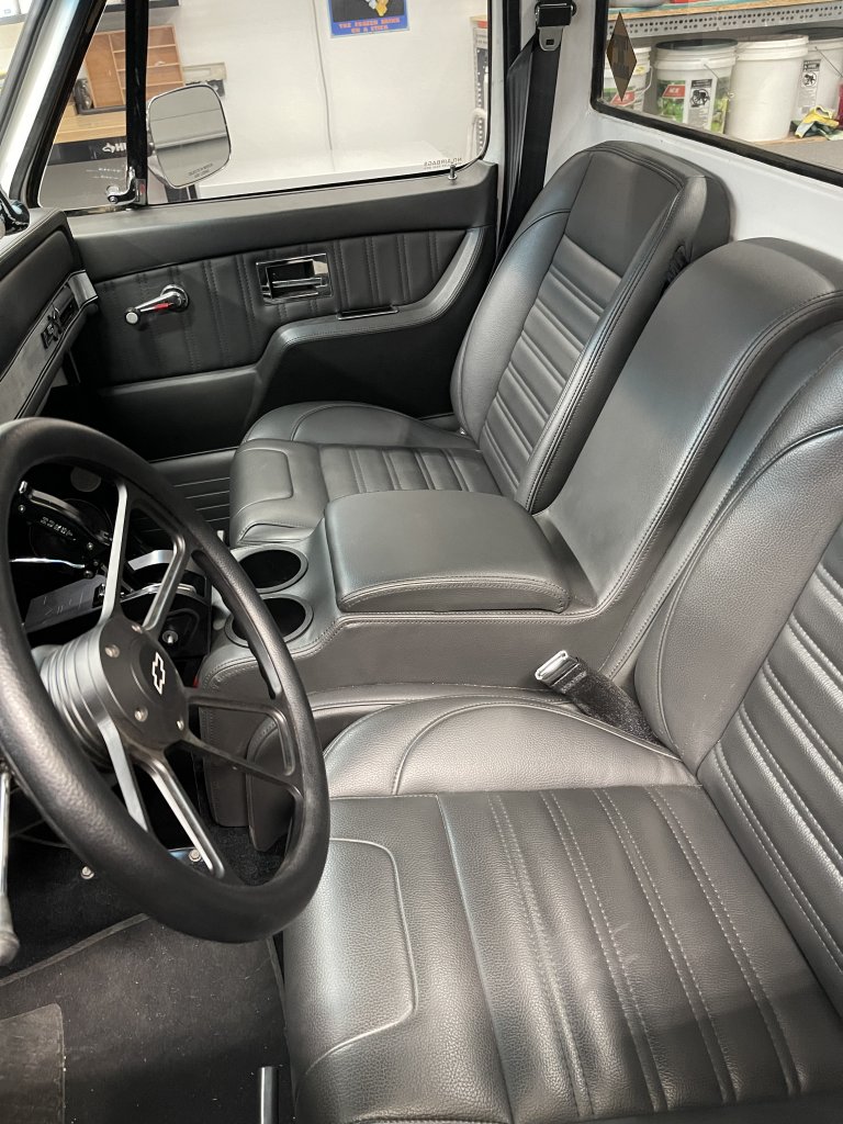

I did a full TMI black interior in my ’83, it came out great I think. It takes a little drilling and fitting, but was all pretty easy to swap and it looks clean I think! I also did an autometer invision digital dash which I love, a hurst shifter as well.
