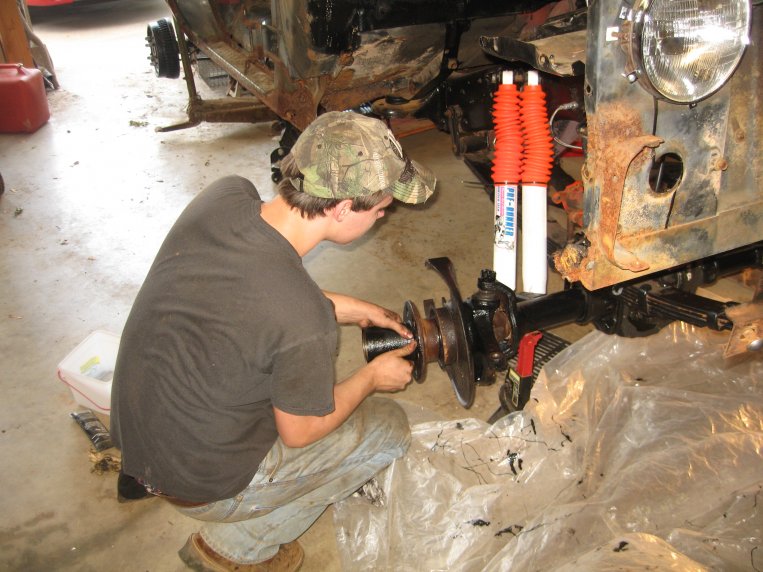

Here is a pic of mine. Now I have a double mount setup. The inner shock is tight between the frame and the original mount. I don't know if you can zoom in close enough to see it though.

Hrm. The only reason the old one didn't slide was because of the bushing was stuck to the shock.
This is dis-concerning and uncool. I need a single shock setup so I can see if the shock is tight to the frame or tight to the bracket bolt side.
