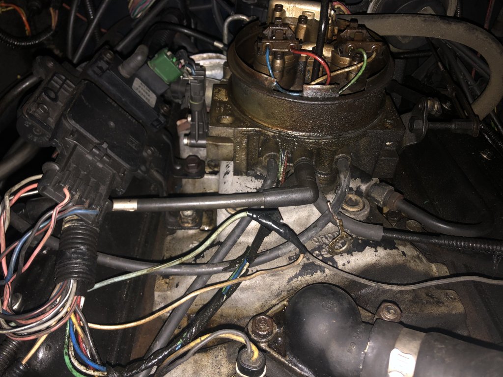

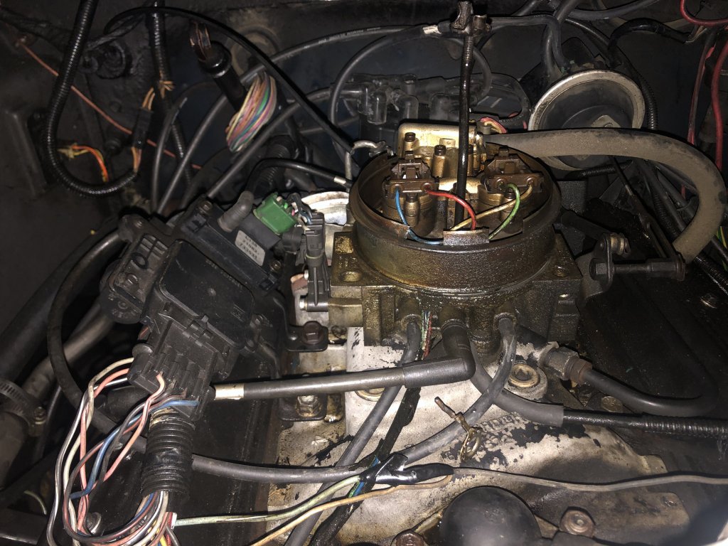

I put in a new fuel pump last year I’m thinking I need to add more grounds , the last owner or mechanic seemed to have removed a block ground and spliced the wire to battery negative post instead you can see the electrical tape. May I need to add a tee to ground to the block and “ground” to the neg battery post
