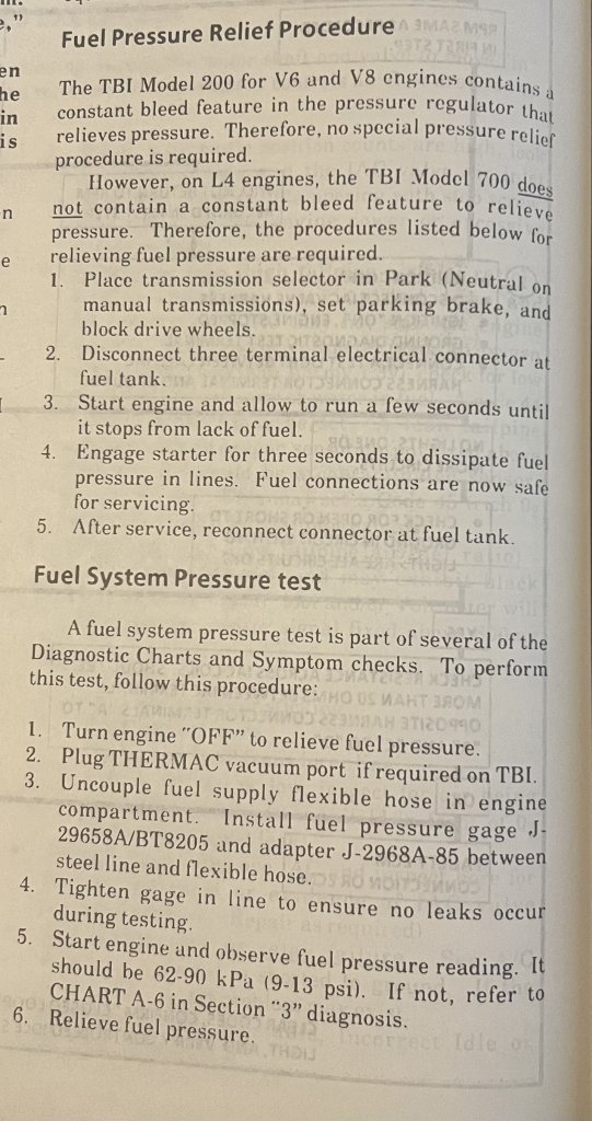

For full disclosure I’m a carb guy through and through and my knowledge of TBI is limited, but I have an ‘88 K5 with 350/700R4 that’s 100% stock. I bought it from my uncle who is the original owner, he’s a retired mechanic and does all his own work. When he sold me the Blazer he gave me a heads up that it takes extra cranking time to fire up, not drastic but like a carbureted engine waiting for fuel to pump to the carb. He said it’s because there’s a check valve in the fuel line (I believe it’s on the pump but not 100% sure) that’s supposed to keep the fuel line charged with pressure for instant starts. He said through ordinary wear and tear the check valve has wore out. It hasn’t completely crapped the bed, but fuel slowly bleeds past it back into the tank. So if it’s not sitting for long it fires right up, but if it sits for hours or overnight or longer the fuel system loses pressure and takes a few seconds longer than it should to prime and get fuel to the TBI.
I never bothered to pressure check the system to see if you and I are experiencing the same sort of pressure drop because at this point it’s not a big deal for me. A few extra seconds of cranking, but when it fires up it runs fine. I’ll ask my uncle about your issue next time I see him.

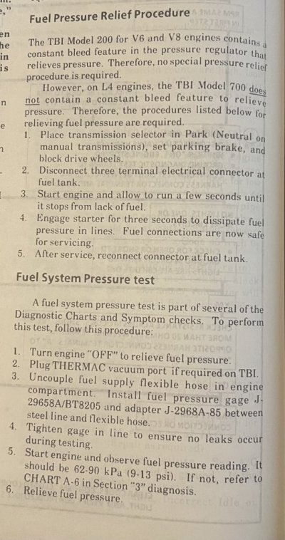

I don't think the TBI system retains any residual pressure.
Again, I’m not super knowledgeable on TBI, but with my uncle being a retired mechanic he always had the factory service manuals for every vehicle he owned and he gave them to me when he sold me his ‘88 Blazer so I had to look it up. I assume not much changed between OP’s ‘87 and 1988. Some TBI did automatically relieve pressure and some did not. For you and the OP:

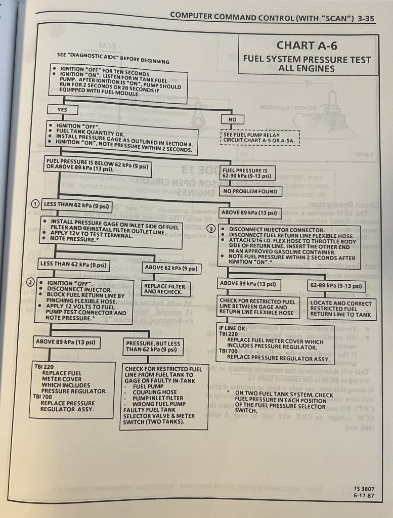

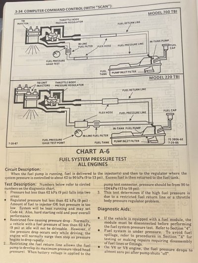

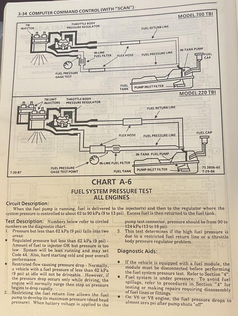

Anyone??? Please!
Is fuel pressure supposed to dip to zero right after key on?
And it's falling quickly to zero after shut off normal? (Or a sign of a weak FP?)
The 1988 Factory Service Manual says in one of the diagnostic tests to note the fuel pressure in the first two seconds and the flow chart goes from there with other things to check. 9-13 psi is the correct operating range of pressure, so it seems your 12 psi of pressure means your fuel pump is probably good unless you go through the tests and find out otherwise. If it was less than 9psi it most likely wouldn’t be drivable. Here’s some bathroom material. Hope this helps. Good luck.
thanks for that info. I have a L05 engine, so never looked into that for the other engines.
All the GM manuals are available in the reference library on this forum. they are a GREAT resource!
31,853
32,544
The 9-13psi spec is correct, but ideally you want 12-13psi because it will run noticeably better than at 9 or 10 psi. Some newer cheapo pumps are only capable of around 10psi right out of the box.
Also, they will actually run at 6 or 7 psi too, just terribly lol.

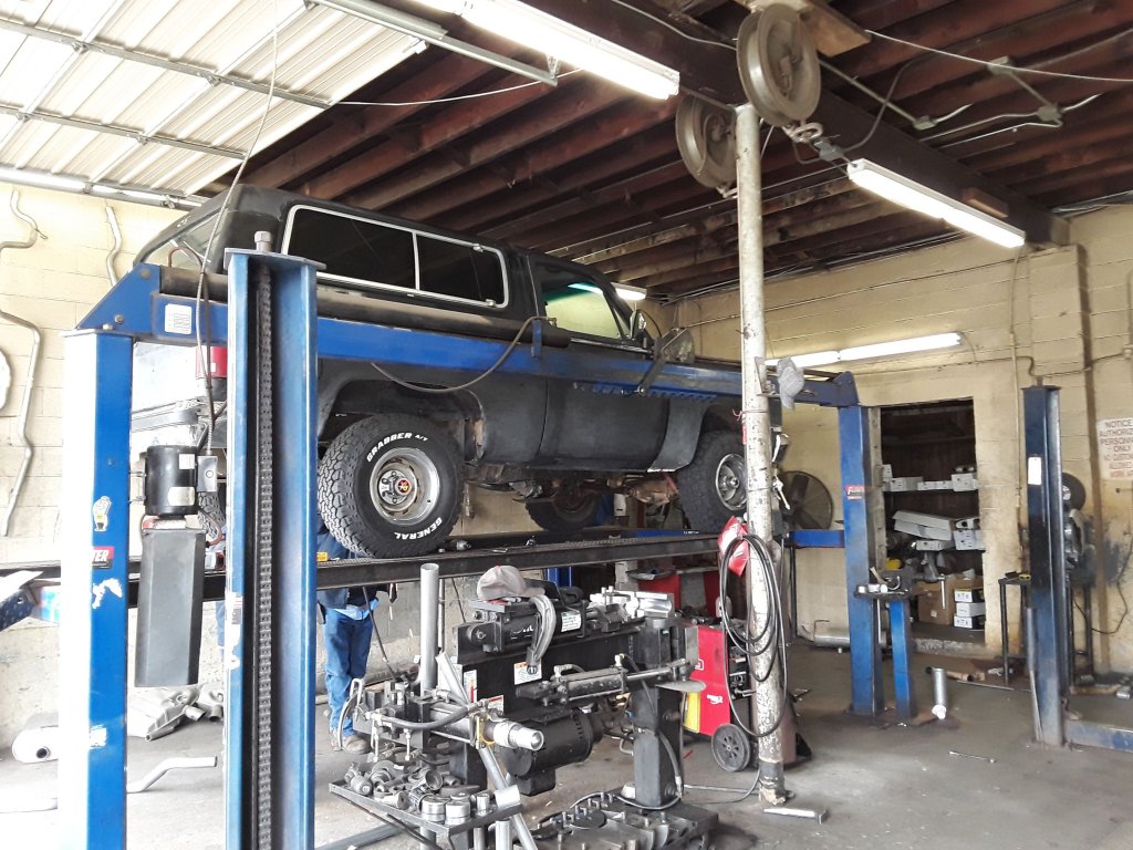

I can fix this.
WE can. I'm gonna help stupervize.
Even got pixz mess around.
I used to have an 88 Blazer
- r.i.p Bonnie Blazer. :(
Simple fix after you drop the tank. Lemme know when you're ready...im at work.
