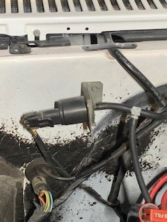

Ben--Is this the switch? It is located on my fire wall. Forgive me in advance for all the questions.
What does the delay valve do?
Using the Ohm meter will tell me if switch is good or not?
Is it ok to drive with vacuum switch unplugged? Does that prevent lock up from engaging? How is that different from unplugging lock up connector wire?
Why would this issue only occur with warm temps? If it was the lock up converter, wouldn't it be a constant issue?
Thanks for your help!
no thats a different sensor i believe it part of the computer controlled carb set up
acts as a buffer for the vacuum signal
yes should have infinite resistance and then have little to no ohms resistance with vacuum applied
Is it ok to drive with vacuum switch unplugged? for testing yes
Does that prevent lock up from engaging? yes
How is that different from unplugging lock up connector wire? it accomplishes the same thing
Not sure? possible scenario, heat reduces engine power so you are on the gas harder which also lowers you vacuum signal.

Couldn't find another switch except the one pictured earlier. Is it possible it is missing the switch?
after looking at the wiring diagram for the 85. it looks like that vacuum sensor is for the computer controlled carb and the computer also controls the lock up on your trans. Im not familiar with the CCC systems and probably not going to be the best of help on this system.

Thanks for you efforts! Are you thinking this switch/sensor in the pic is the one for both carb and lock up?

Also if it controls both carb and lock up that could explain why I am also having a stalling issue at similar times with warm weather?? Truck will stall while driving as if there is a fuel problem. Pull over and will start back up in minutes.
yes that sensor feeds manifold pressure info to the computer then the computer controls the carb and lock up
