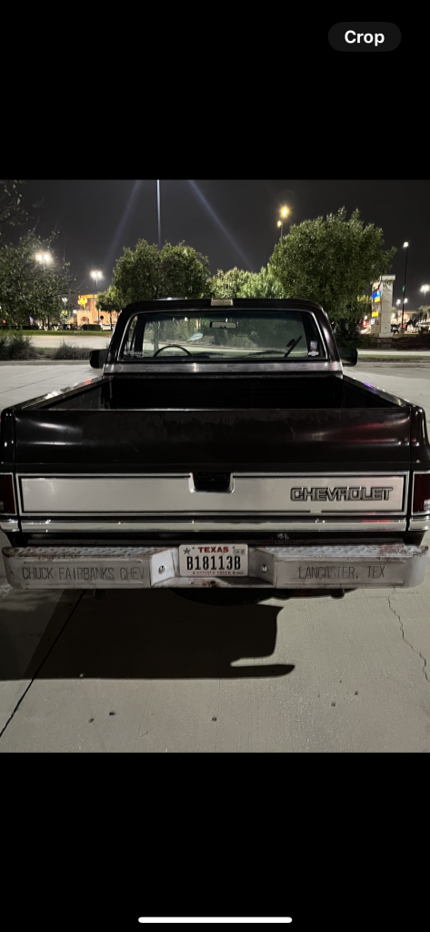

Hi all,
Does anyone have success with installing a hitch like this on a factory step bumper?
Looking to be able to have accessories like a dirt bike rack and also tow a boat (roughly 3500 pounds).
Pictures of my bumper and potential style receiver.
If this wouldn’t work, what frame mounted receiver would clear the step bumper?

This is a Draw-Tite frame hitch. I modded the setup a bit for a spare tire carrier, but you can see how it sits in relationship to the bumper. If I were towing even anything about the half the weight you want to pull, I'd opt for the frame mount every time.

What model number is that? Did you have to undo any of the stock bumper bolts or did the brackets use pre-existing holes?
Looks about as flush as the bolt-to-the-bumper option which is why I liked it so much.
I think I have a different style spare tire holder so I may not need to modify anything.
If the bumper itself was rated for 4,000lbs, I do understand that adding a ball a few inches out and below where it wants the ball to be changes the dynamic around, just not sure how much. Luckily, I am only really towing short distances or across town (50 miles at the most)

I'm going to go out on a limb here and suggest that if you stay below the ratings on the step bumper and use that bolt-on with a receiver hitch that raises the hitch ball to the same height that it would be on the step bumper you won't have issues with the bumper rolling. The step was designed to take loads on the horizontal center line of the mounting. Lowering the ball puts a torque load on the bumper in braking. If you use a step up hitch to keep the loading in the same plane you should be fine. I'd still keep the tongue loading light since extending the hitch behind the bumper puts a slight torque load on it too.
