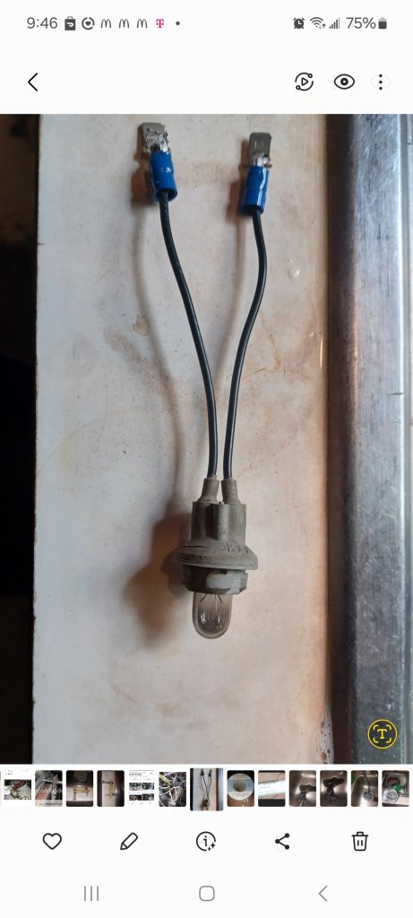

Use a light bulb instead of a fuse, a 194 bulb and socket works good. Now you won't have a dead short the bulb will be the load. Turn on your switch as before,now look at your 194 bulb,start wiggling harnesses watch your 194 bulb for changes in brightness blinking etc. Start disconnecting checking wires for bare spots,etc.

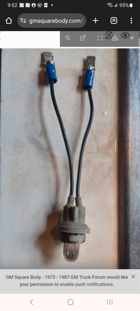

Funny thing is I have that tool,bought new,about 30 years ago,still,unused. I always can find the short before I need those. I wonder how much time I ve wasted finding shorts with a light and a multi meter over the span of 30 years!? A pic of my favorite tool for finding shorts. It's that same 194 bulb from a few posts back. And another one, of my favorite tool for holding wires while I solder, yep,that's 2 clips with a piece of solder between them.

2 clips with solder between.. thats genius.

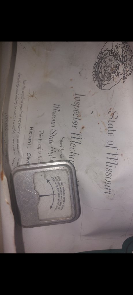

Referring to the short finder, that little "container" with the 2 leads, has a circuit breaker inside. The leads attach to those fuse terminals. The breaker makes and breaks enough that the wiring doesn't overheat.. The ammeter is an inductive pickup.. Starting at the fuse box wiring harness, the meter is moved along the harness. The meter senses the direction of the current flow. It "magically" points in the direction needed to move along the harness. When needle movement stops, the source/location of the short is found.. The tool will also work in the situation where a fusible link it consistently blowing.. Simply install the breaker in place of the fusible link and start at that point with the ammeter.
As I stated, I've had 100% success using the tool. I can usually locate the short WITHIN half an hour.. Most time, no disassembly is required in the locating process..

Oh I had no idea you had that tool yeah I bought one,still haven't used it. I'm going to go back through and read how you say it works,I always assumed it was a 2 prong flasher relay,and an inductive ammeter. I'm glad you've had luck with it. Real deal is old habits die hard,I started doing it the hard way years ago and just haven't given up yet.As for the light bulb you use it in place of the fuse and keep going back and looking at it or make one with longer leads. I have one with 6 foot leeds,it's cool because I can put it under a windshield washer blade and see it from the seat while I see if I'm getting power to say the starter solenoid,a washer, pump,injector,headlight,etc. The long one has tee pins instead of blade connectors,so I can backprobe a socket. I'll have to try my short finder out someday.Maybe. Damnit now you've got me excited to use it,I've never even tested it I'll I've ever done was bought it in looked at it,put in the tool box,and it just never comes to mind to use it.

Okay,now I'm p!ssed and it's all @RustyPile s fault. Went to find this tool I never used and I could find the gauge,but not the sender,and in my search found my first MVI license its all curled up from just sitting in the tool box forever. Who'd a thunk? So anyway I always theorized the sender was a flasher relay,do you think it's a breaker or a relay. Second of all I want to straighten out my old license and frame it as an old treasure,ideas on how to flatten out curled stock paper?
