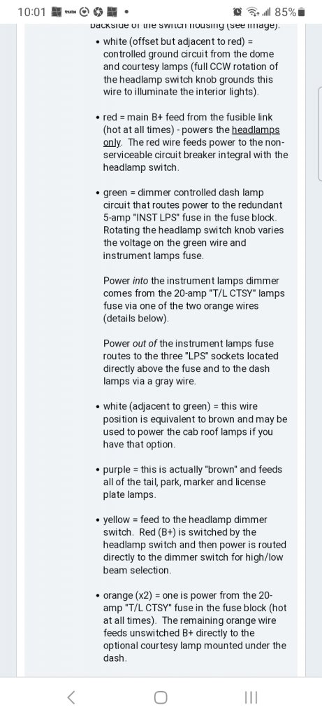

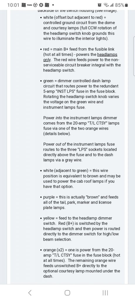

Factory wiring for Chevy truck like 1975-85 I've attached a pic,look at what the red wire does. Go look at a factory 73-86 Chevy pickup fuse box. No headlight fuse. I don't care how you wire it,it's your truck mine I'd want it wired like GM designed it which is as simple as just rerouting the 1 battery lead that is headlights only. Then the factory circuit breaker in the factory switch will do its job as intended. I put a link to a website that describes how the factory circuit is supposed to work,anyone who hasn't read it yet,probably should. It would clear up a lot of confusion. I just linked it again.

Sorry @Ricko1966 forgot you posted a link on the first page. Read up on that, makes total sense. Thank you

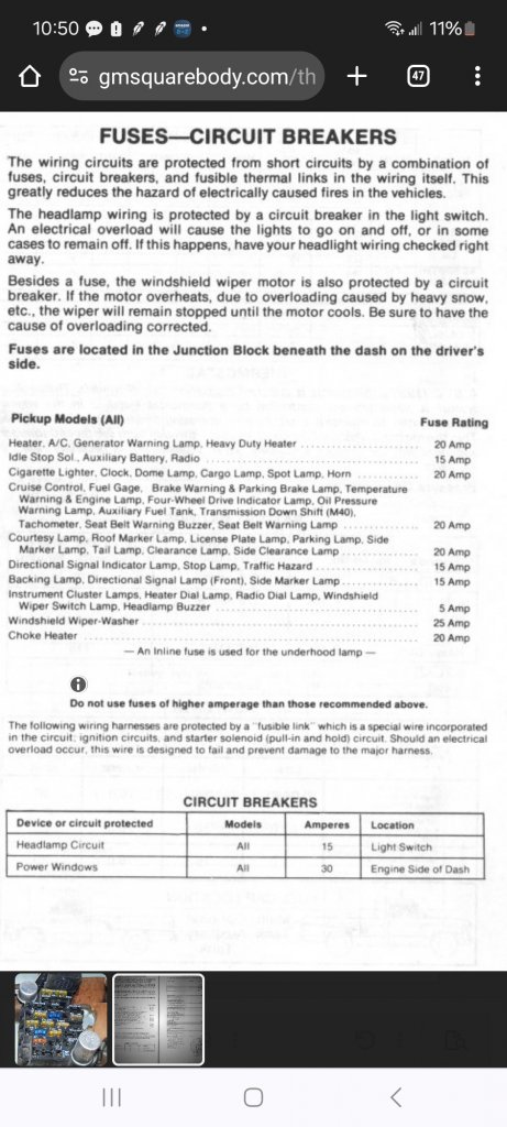

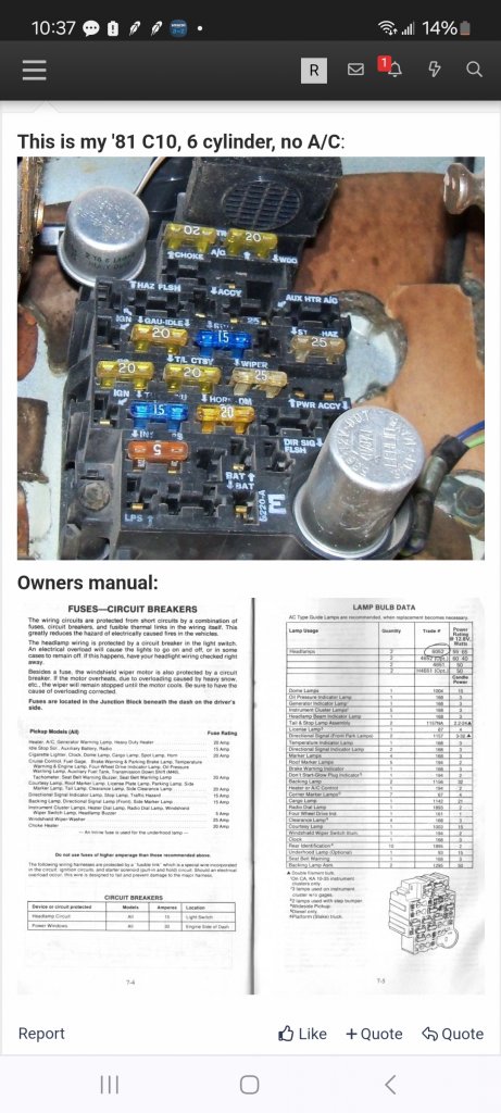

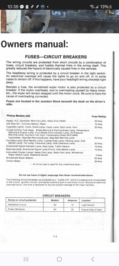

This popped up tonight on another thread. Kinda funny because I was thinking about this exact thread yesterday. ( mowing,way to much time to think about stupid sh*t) Anyway was just thinking about how this harness went retro decades on the headlight circuit,but no one would consider down grading their brakes to 1960 standards. Someone posted his fuse section from his 81 owners manual,so you can see this is how it was designed factory. IDC I just want anyone considering using this companies harness to know they should consider an alternate lighting circuit. Easy to do it's just 1 more wire and a factory switch. You are not supposed to be able to pop a fuse and lose your headlights. Taillights NBD headlights fairly dangerous.
