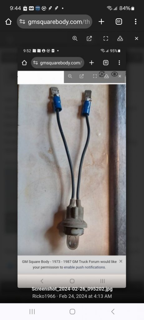

Pull the fuse put a 194 bulb and socket in place of the fuse,if the draw is there the bulb will light. Now start disconnecting everything on that circuit until the light goes out,when the light goes out you found your problem.
