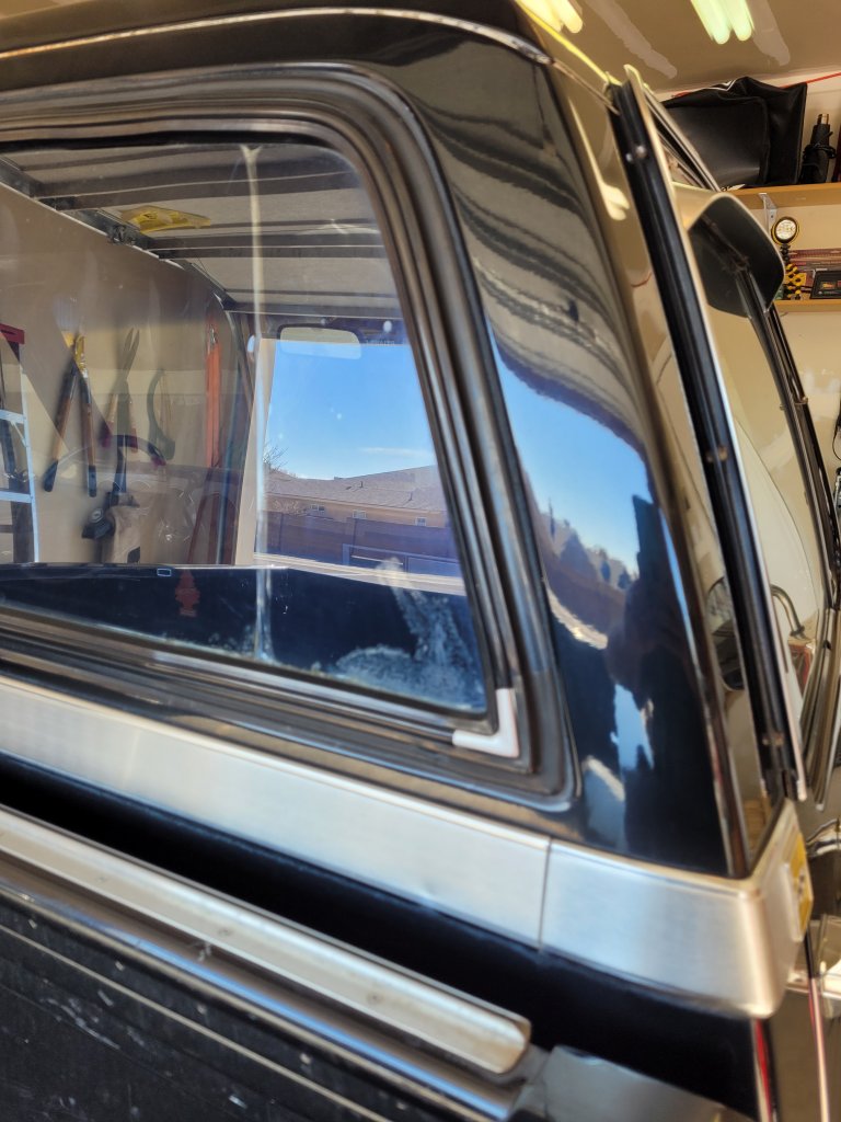

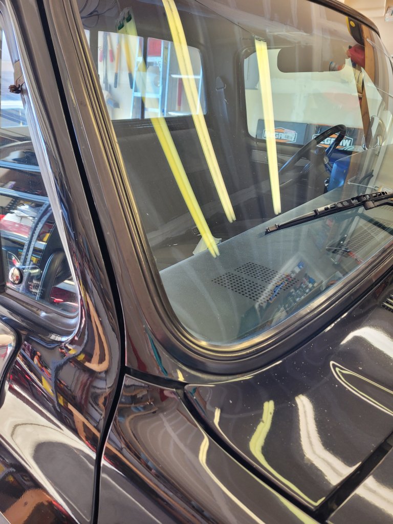

Looking to replace my windshield and rear window (with a non slider). Anybody know what the stock trims look like? And where I might find some quality pieces that look stock? Here is what I have now and I know they are not original.

Yes - especially 87. My truck is an 87 Scottsdale with black trim. It's one of the reasons I ordered the Scottsdale trim level (among others).
Yours sounds like a misbuild from the factory, or the trim has been replaced at some point.

Interesting. My Silverado has all the extra options like, 350 v8, 700r4, power windows, power locks, digital tape player, dual tanks...
Maybe someone had an off day. Trim looks original but you never know.
Also not to belabor the point (engineer in my past life and OCD) but this 87 Silverado looks to have a black lock strip too.
