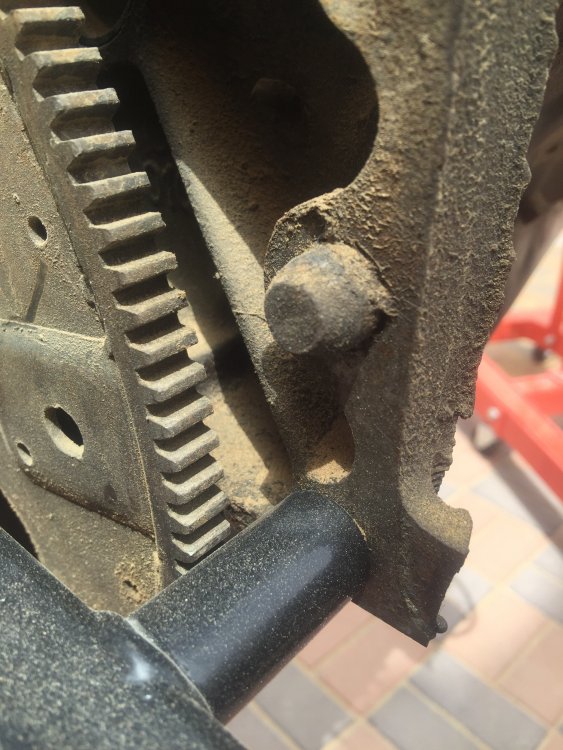

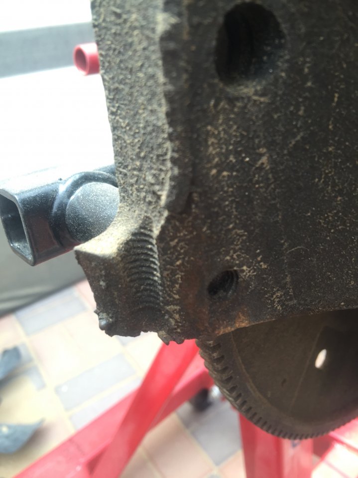

Found a bigger problem though - plans to drill inboard of the old starter hole? THAT hole would come straight up and intersect the lowest right block-to-transmission thread - straight through the middle of it
- bugger!!!

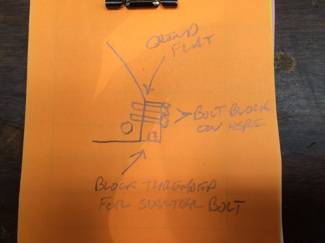

Here is another possability????

That might work, but might introduce more weak areas in the block for it to crack again, in a different place maybe?

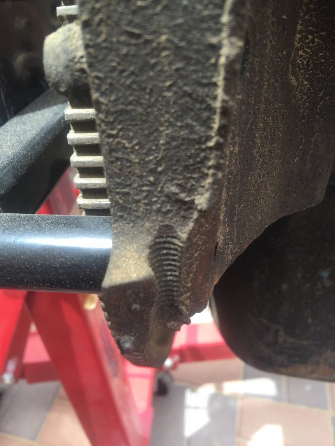

Another fix....
Another possibility may be fix a shorter 'stud' to the transmission-block attachment point and drill up vertically behind the stud for the starter motor? Wouldn't be more than 3-4 turns in though?
I realy think I'm going to have to have a crack at Cast Iron welding to get this sorted. Crickey Mate!

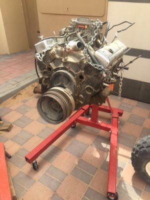

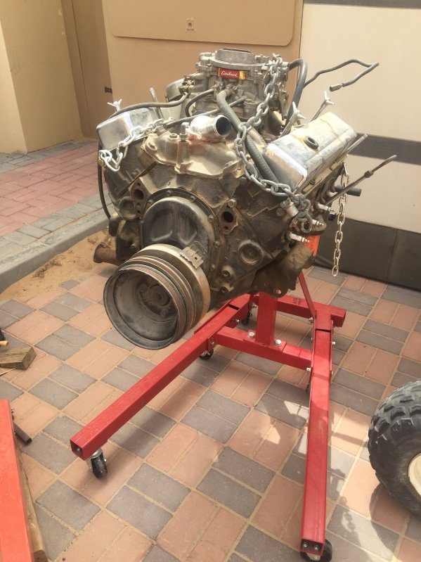

Here's some pics so we're all on the same page...

Welding Cast Iron Block...
Is it just me? I reckon someone's prep'd this and tried to weld it previously - unsuccessfully, obviously....

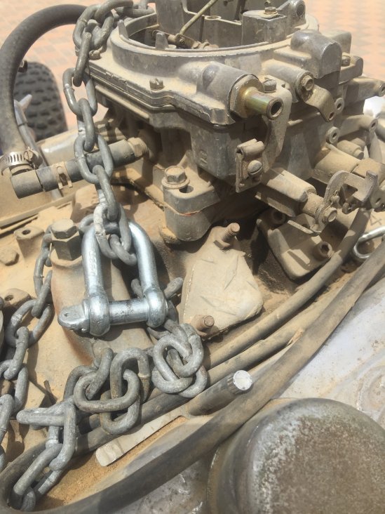

Intake Manifold fix???
Here's some 'dodgey brothers' manifold fixin' too! What the.... !!! Nuts!
Really starting to wonder what the inside of this thing looks like?
