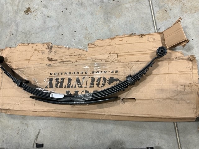

On my son's 84 swb k10 build, we are going with a 6" Tuff Country spring lift. He's convinced the rear springs are going to be too stiff and wants to remove a leaf. I've cautioned against that, as we don't have it installed and fully weighted, and the number of leafs isn't necessarily going to mean a rough or smooth ride. Further, the design is based on the lift height and removing a leaf could impact ride height. Metallurgy and spring rate would drive ride quality, in my uneducated opinion. I see some other posts with aftermarket spring kits with owners happy how they ride. I'm wondering though, does your spring lifted square (no blocks) ride better than stock?

Leaf spring trucks ride like crap, it’s the nature of that type of suspension - make sure he understands this. That said, I agree with you, put it together as is first and see how it is.

Unless you're spending money on product like Offroad Design (ORD) it will ride stiffer than stock with a set of 6" springs

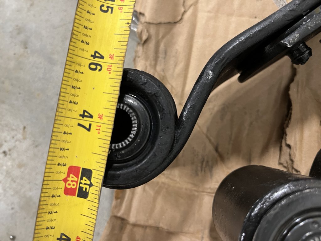

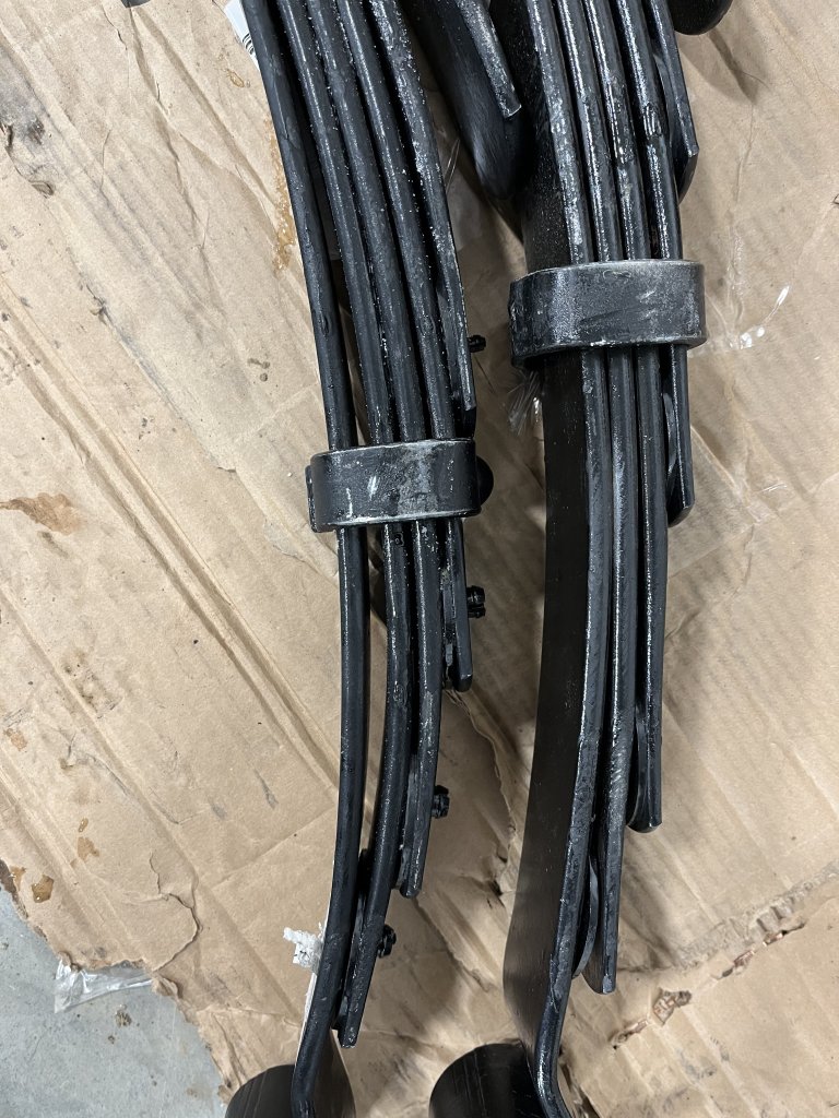

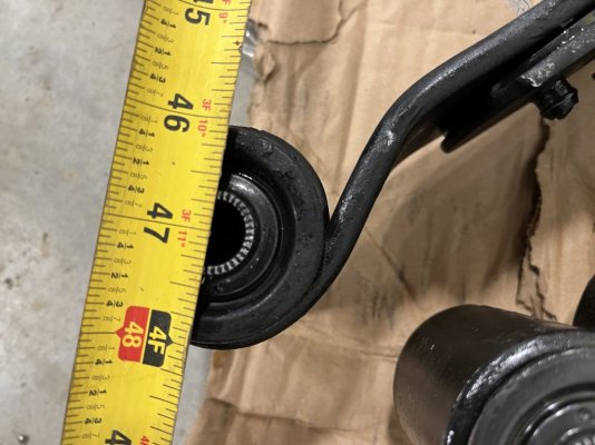

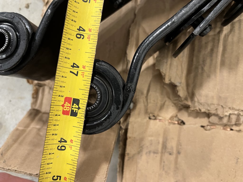

Thanks, that’s good to know. I got the second rear spring delivered today, and after looking at the overall quality of this kit I will probably end up going ORD. Maybe this is irrelevant once installed, but the on center measurement is 5/8” different between the two. One set has Mis-shaped leafs which I don’t care for. Am I picky? Extremely. But the TC kit was not cheap and guess i just expected better.
I don't think that center to center measurement across the arch is too big a deal. Probably happened during assembly. All springs relax a bit when you get weight on them and drive it for a few weeks. They should level out to about the same height. If you're concerned about the springs, measure the length of the top leaf, along the leaf from eye to eye. That measurement should be within 1/8" or so. You may find it a benefit to have one spring just slightly taller. Look for the "Chevy lean" while you have the frame on jack stands, and put the taller spring on the low side
That's probably true. However, since the eye to eye measurement is based on a single top leaf, either one spring is actually shorter or the arc of that spring is off. Admittedly, I have not measured the arc, and 5/8" length over 48" vs. the arc is probably immaterial. I just expected it to be closer and for the whole spring to be of better quality. Its very poor, in my opinion.
Just to satisfy my curiosity I measured the arc, and they are about 1/2" difference.

That sounds like a little much to me. I think you're right to send them back. The other measurements you can take are from the center pin along the leaf to the center of the eye. String a wire from one eye to the other and measure from the center of the top leaf to the wire, that will give you the amount of arch.
