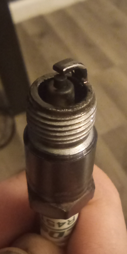

So my truck smokes a lot way too much. Not black smoke. Start up and driving it smokes. always has ,since I got it 1 year ago.i haven't driven it much maybe 30 miles. I changed the spark plugs a week ago. They were f*cked don't know how it even ran And don't know how old spark plugs have been in. Anywho I thought valve seals the rope method. I only took apart the number 1 cylinder spark plug and exhaust valve spring. Not the intake spring yet. It had a hard umbrella seal with no o ring and it was chipped at the bottom not sure if I did it when pressing down on spring. Do I need both new umbrella and o rings. Or just one or the other. Also here is a pic of the new spark plug after driving it maybe 4 miles since I have changed it last week. I've never done this and any feedback would help.

Is the head cut for PC seals? If so get a set. If oil is migrating past the guides those seals will substantially reduce oil consumption.

Pull the plugs, disable the ignition, wire the throttle wide open, and do a compression test.
Rule of thumb is there shouldn’t be more than 20% difference between the highest and lowest cylinder. Be sure to crank the engine the same number of pumps on each cylinder. The first pump of air should equal at least half the final number.
If the numbers are low but fairly even, that indicates a possible timing chain issue. Put a few tablespoons of clean oil on the cylinder, do the compression test again if there is a huge increase, then the rings are shot.
You can do a leakdown test to further test the health of the engine.
If it pours blue smoke out the tailpipe but otherwise runs well, most likely it’s just tired.
