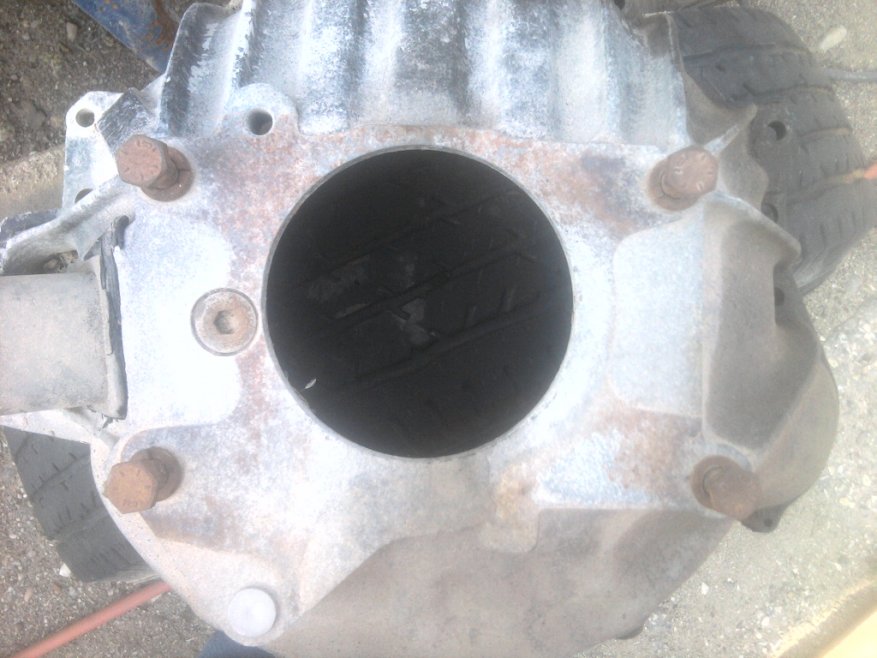

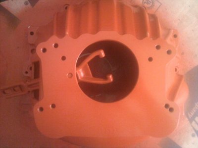

the bolt patterns for the tranny to the bell housing are different
the nv4500 will not bolt to the sm465 bell housing
the nv4500 pattern is wider than the 465
people have made it work but I have not liked any of the ways they have done it
I have done a nv4500 swap in my 85 with a 208 and I am doing another with a 205 in one of my 1 tons
the orange bell housing is the advance adapters nv4500 bell housing it has dual bolt patterns for the 465 and the nv4500 so you can see how different they are
the other bell housing is a 85 up square body bell housing for the 465
the orange bell housing is the advance adapters nv4500 bell houusing it has dual bolt patterns for the 465 and the nv4500 so you can see how different they are
I can handle redrilling a sm465 bell housing better than buying a new one or a lift kit

there is not space to redrill the nv4500 bolt pattern on a sm465 bell housing
I have seen the cast iron bell housings from older trucks with a bunch of crap welded on them to make them work.
and I have seen a thread where a guy drilled and tapped the sm465 bolt pattern into a nv4500 and put the bolts threw the bell housing into the nv4500.
really when you have to replace a nv4500 because you were trying to save a few bucks on a bell housing and you destroyed a nv4500 ask yourself if the 366 bucks and a advance adapters bell housing would of been a better way to go
http://www.summitracing.com/parts/add-712577/overview/make/chevrolet
I figured I saved money and time instead of hacking together a bell housing that will not be right and possibly could destroy my nv4500. I just bought the nv4500 one from advance adapters.
I have used the factory nv4500 bell housing with 6'' lift
