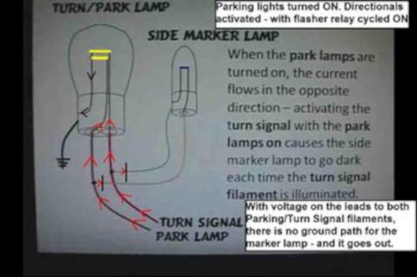

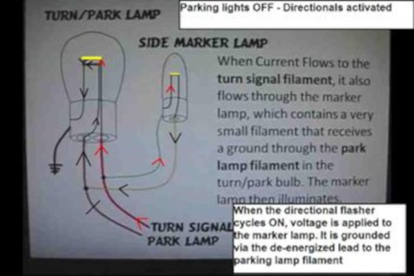

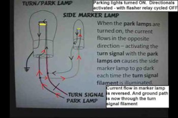

what do you mean by DIM? you have no light or its barely lit?
are you saying they are never fully bright?
You may have gotten cheap LEDs.
you also may have LED 194 which are only going to work in either function but not both. they make ones that can do both. by both, i mean sidemarker and then alternates with turn signal. the way its done electrically is the 194 receives 12 volts on both sides of the bulb when it "flashes" and its grounded on one side when its just park lamp/sidemarker.
Then when you reverse the bulb, youll get the opposite behavior.
This ^^^^
LEDs -light emitting diode- diodes only let current run one direction (unless they have been modified some how)

My vote is for the wrong type of LED 194 bulbs. I had a similar issue and solved it with the "correct" LED's.
