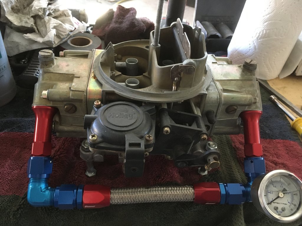

Here is a pic of the 454 holly 4160 converted to a 4150. Much better then the Carter AFB.

Proof is in the pudding...

Easy Taylor, just stating a fact in my case. Also that holly was setting right in my cabinet, so little outlay. You get used to a (put here,) certain thing, for me I have been working on holly's for fifty years at least, it is formular and comfortable. He asked for pictures, so I posted to help him out.....
