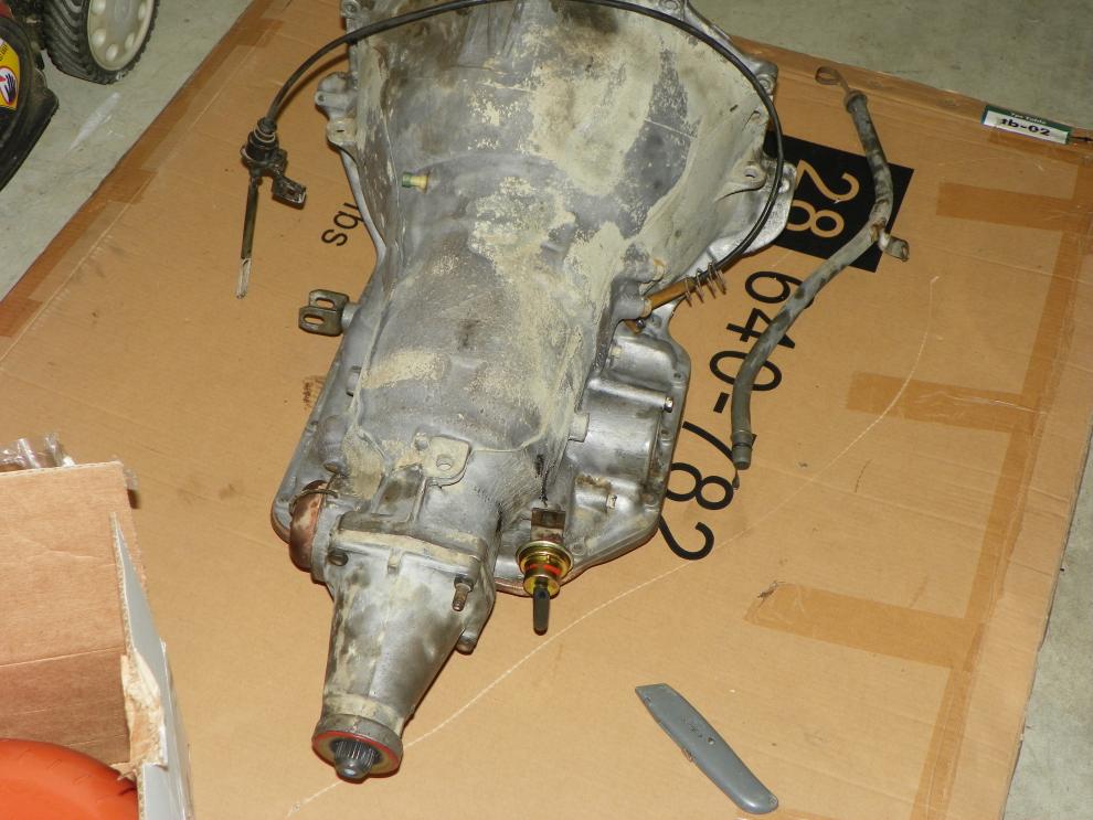

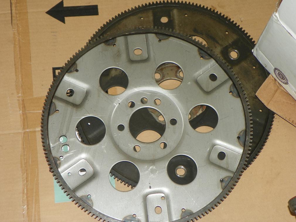

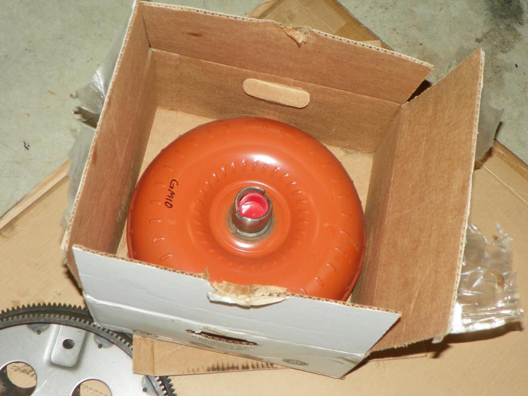

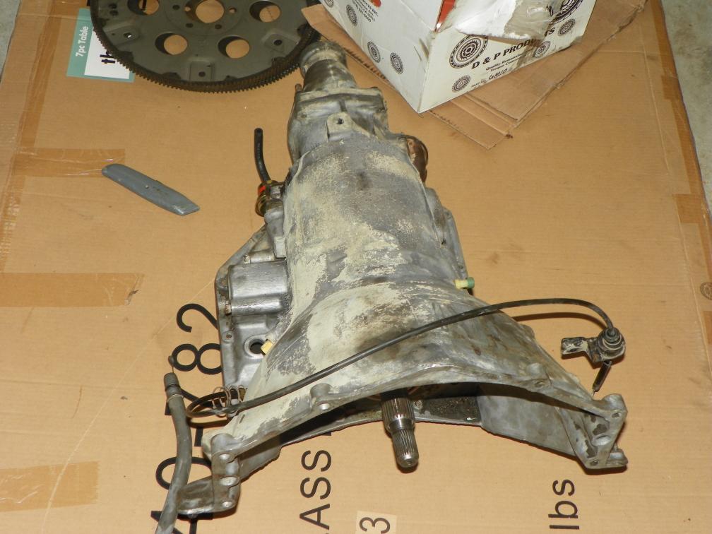

Got my tranny back this evening, ended up costing me $600 for the re-build.
Gonna stab it in on Sunday.. wish me luck.
BTW... anyone have an idea what the torque spec is for the tightening of the flexplate to the engine crank shaft? (don't want to crack the new one) much appreciated....

WOOOOHOOOO!!!!!!
Got my tranny in a runnin', had a little snag though. It wasn't shifting at all, and had to take it to the guy who re-built it. I could shift it manually, but that's why I have an automatic! LOL
He had to replace the governer I think. He pulled that vacuum doo-hickey off of the back and pulled out something and replaced it, and voila!!!! He showed me how to adjust the shif points with a little screw driver, and there you have it!!
BACK ON THE ROAD AGAIN!!

that's the vacuum modulator valve and it's got the adjustible mod valve to let you dial in some preload on the thing or take it out.
IMO though sounds a bit shady to have a newly rebuilt trans and have to change something right off. I don't like that one bit.

Things happen, I bet he forgot to put the vac mod valve in, in the first place. He probably found it and realized it as soon the trans was gone so he knew exactly where to go. Governor is on the other side in the round dome.

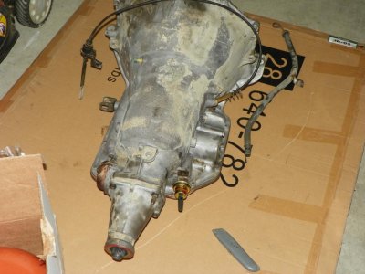

Yeah, he checked the "dome", popped it open tinkered with it, drove it around the corner, came back and said "nope, that's not it",
then he popped that vac pod off and pulled something out of it and grabbed another of whatever it was and put it in, and locked it back up, took it for a drive and came right back and said.. "your good to go". He was saying that it was shifting soft, and showed me how to adjust my shift points to how I wanted it to shift..
Screw in.. shift tighter,
Screw out.. shift looser. I screwed it in and drove it a few times, till I got it shifting like a clock.
I understand what Swims350 is saying about seeming suspicious, but who do you really trust these days?? it's tough to find someone that's worth a dang anymore. How am I suppose to know he gave me new parts?? You know? He coulda pieced it together with stuff he had at his shop already and showed me a box of someone else's used parts.. you never know..
I have to just have faith that it's honest work. I did ask around though, and he did have a good report from a few people.. so that's what I was riding on.
But It's not like he tried to cheat me on the modulator.. (which was the area of trouble), it seemed to have a brand new one there when I brought it home

I'm certainly not knocking the guy. How this went down is totally normal. Vac modulator and detent throttle pressure cable always needs adjusting after install. He did a bench build as I understand it, and you installed it yourself right? If the guy is like me, he has parts to several transmissions at his disposal and they do sometimes get mixed in. Obviously he didn't forget the mod valve if you seen him take one out. Mod valves aren't something that usually wear out, but if the one he swapped had a burr on it, then it wouldn't move so he swapped it. You don't see things that can be wrong with most valves. Unless you use a micrometer on each and every valve, you'd never know. Experience comes in when you KNOW which valves will frequently wear and you measure those ones everytime or replace them everytime. Being this valve doesn't normally wear, he likley didn't measure it and I woudln't have either. With your above explanation, I think he did just fine and I'm sure he did a good job. I notice you got a reman conveter. Some shops just flush them out. New converter tells me, he likley did a thorough job, but as you said, you never know. This is whey when I build a transmission, I normally put all the replaced parts in a small box, even the soft parts along with the hard parts. When the customer comes to pick up the transmission, I'll go thru the parts with them and explain what I found, what was broke, what was wore, what was good etc. This way they see all the seals were replaced, clutches replaced, why the hard parts needed replaced that were replaced so the customer can be confident they got a good thorough job. If I'm putting my name on it, its going to be done right or I won't do it at all. I won't even do patch jobs when asked ot do so. The biggest part of a build is the labor. You're going thru the same motions to put good used parts in it as you would brand new parts. To save the $100 on using used parts for the same labor just isn't worth putting my name on. Granted, I have accumulated some good used parts from rebuilding transmissions in the past, and I will buy a reseal kit for $15 and build my own transmission out of used cluthes for a back up vehicle or a vehicle that I might be selling, but even then, I know how to tell when parts are reuseable and will still work for years and many thousands of miles or I woudln't even waste my own time. I think you did just fine Calidude!!! :waytogo:
Well.. thank ya!! I really do understand what your saying, and the guy seemed to know what he was doing, and yes it was a bench re-build, and the t-converter was new,as well as the flex plate. I was trying to be as economical as I could by pulling it out myself, (with plenty of help, of course)..
I really do enjoy working on my truck myself, or most cars for that matter (my girlfriends car.. mom's car..friends cars..etc), I just wish i knew how to re-build tranny's, or I would have tackled it myself for that matter.
However, I seriously doubt that I'm going to have anymore problems with it. I drove it around for about a good while at different speeds and such, A/C blowing cold, and Steely Dan in the JukeBox :)
She really hummed along with no hesitations with the tranny. I really do appreciate your input.. very much so!! I really do get a majority of my info from you guys here on this site. Talk about a treasure trove of info!
