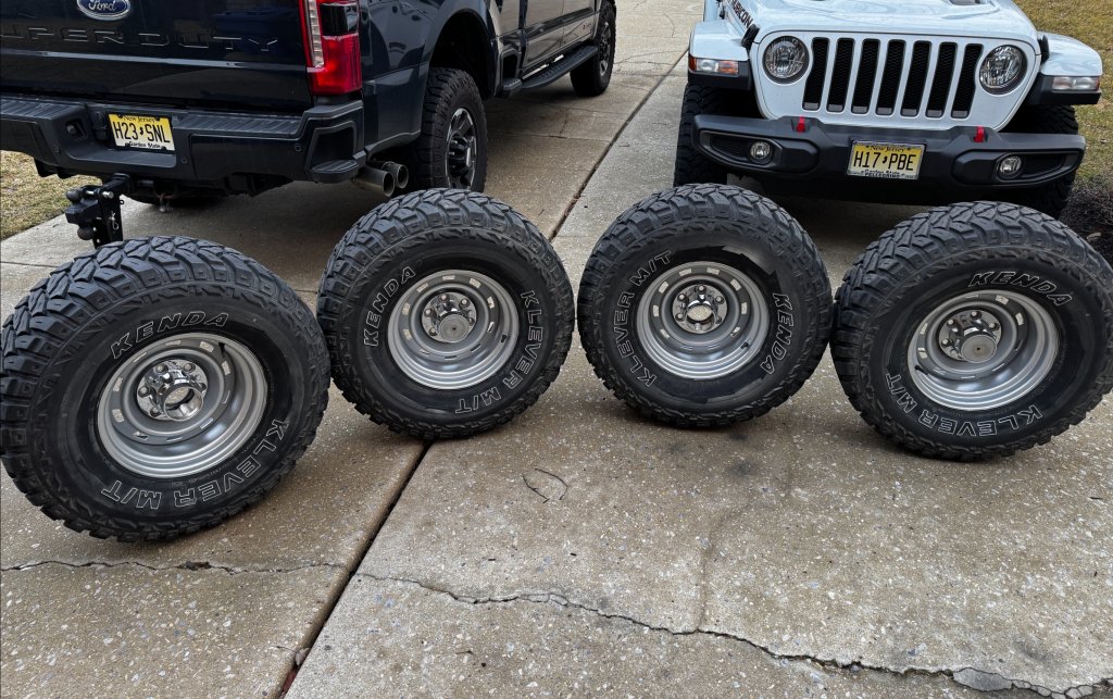

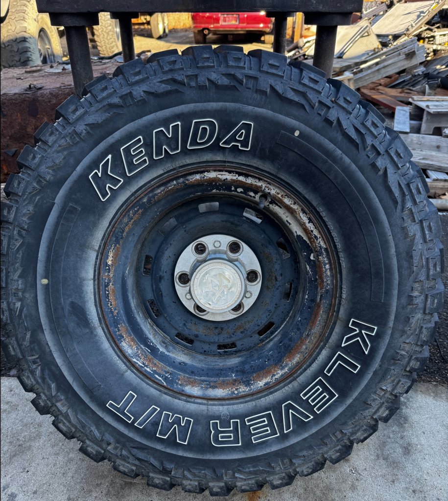

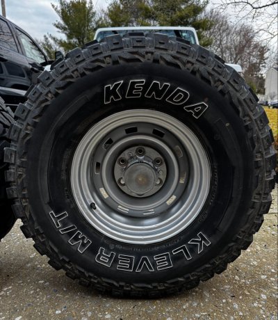

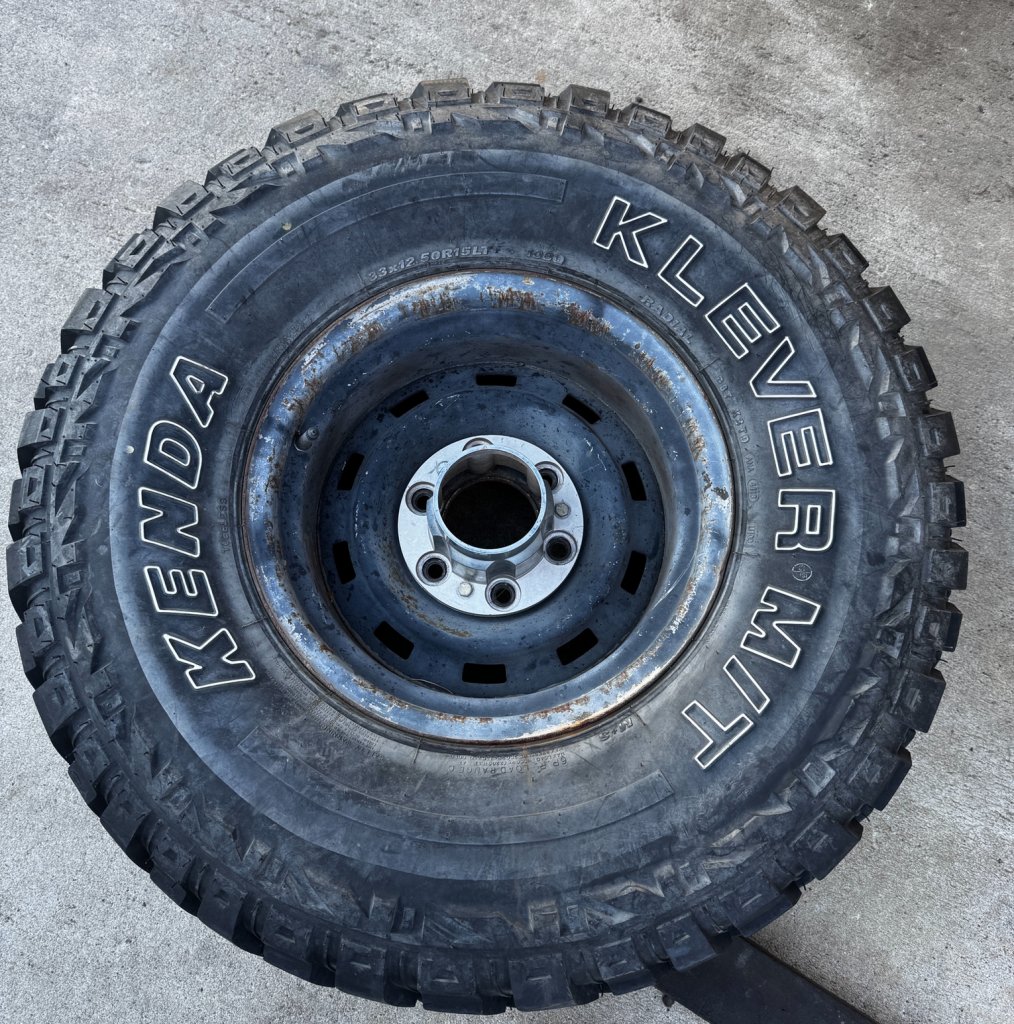

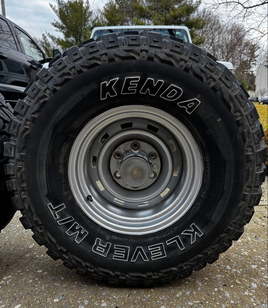

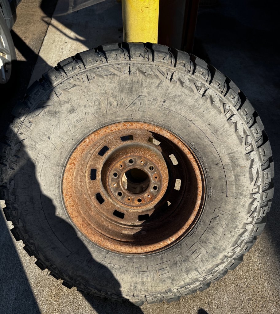

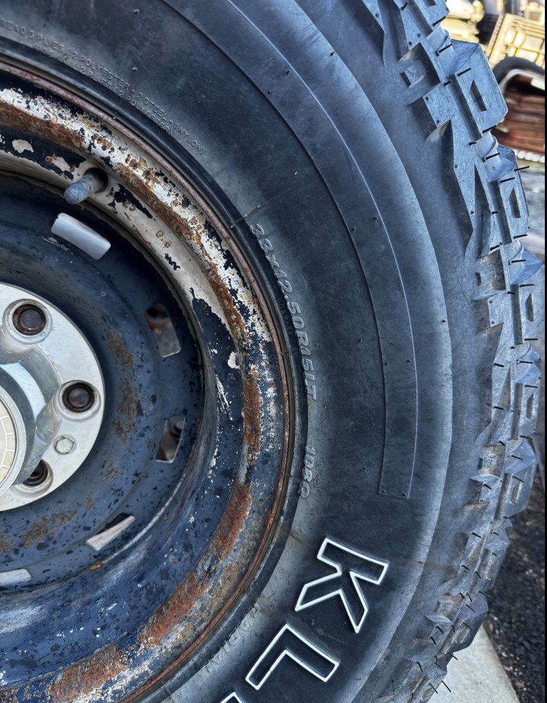

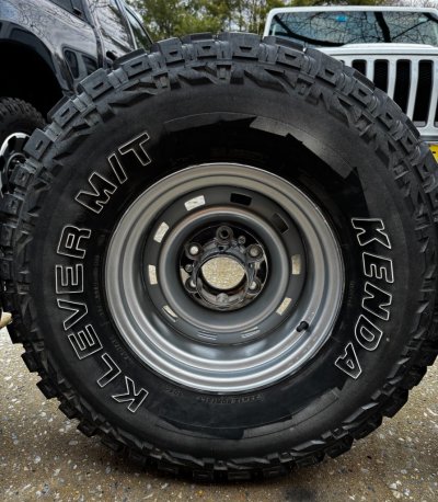

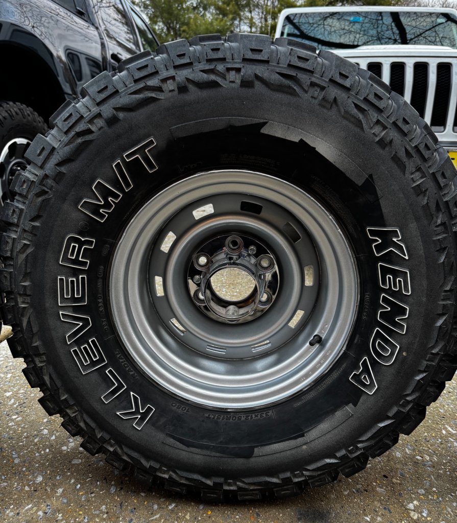

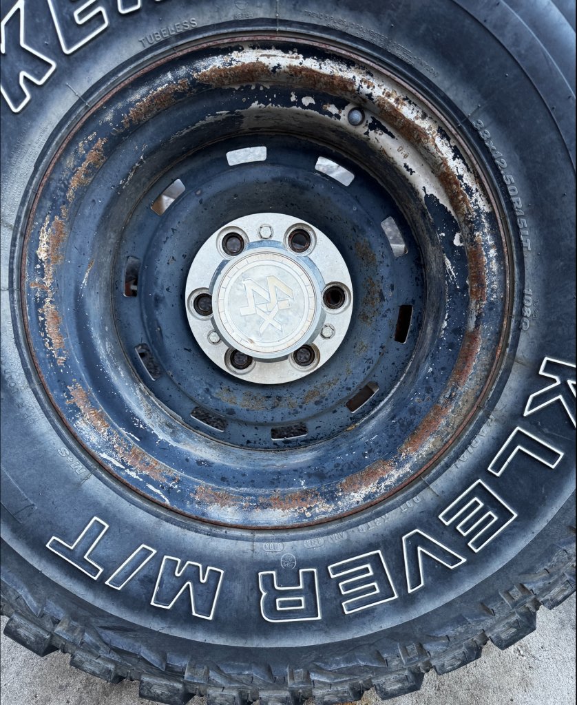

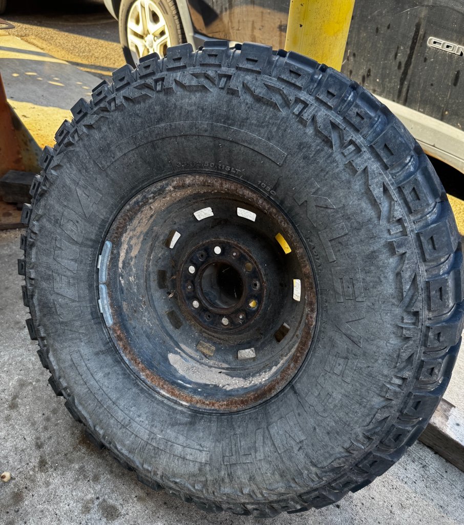

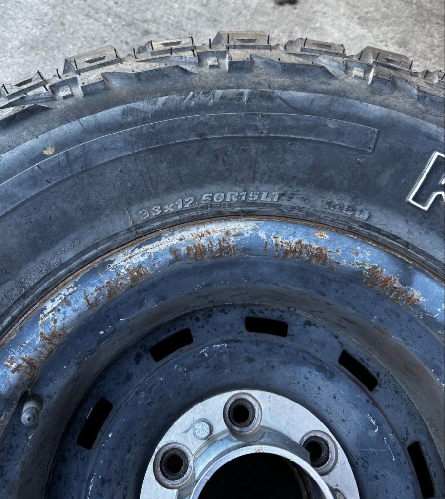

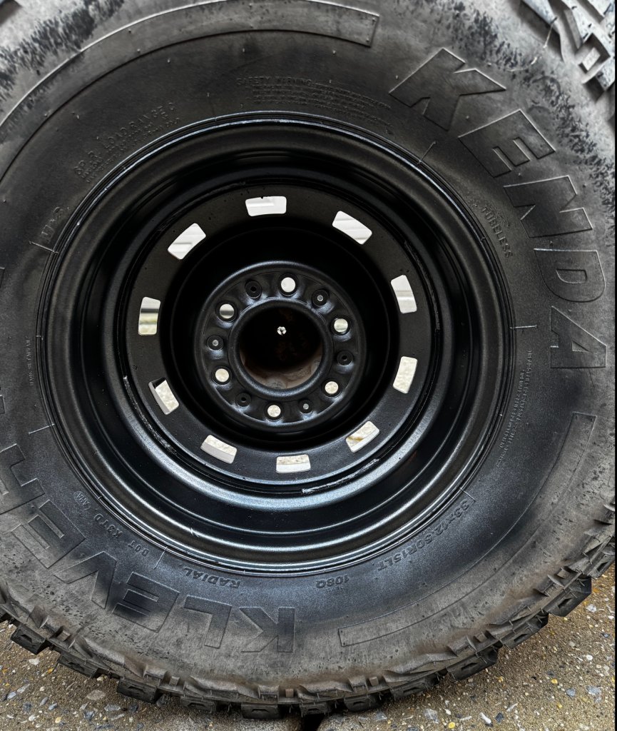

I did some work on the wheels and center caps. New tires should be on soon and truck will be back with a solid baseline for me this week. Next step for me and my buddy is prepping the interior so he can paint that and we can get that all put back together and actually start driving this baby. I’ll post all the things that the shop did. It will be a little frustrating as I am sure a number of the things they did will have been things that I would have been able to figure out how to do myself. However with him having it there and me not really sure how to do much of anything at this point it seemed best to let him confirm/get it road worthy and then I will try to take it from there. Sorry for rambling I’ll post some wheel pics now and the work list when I get it from him.

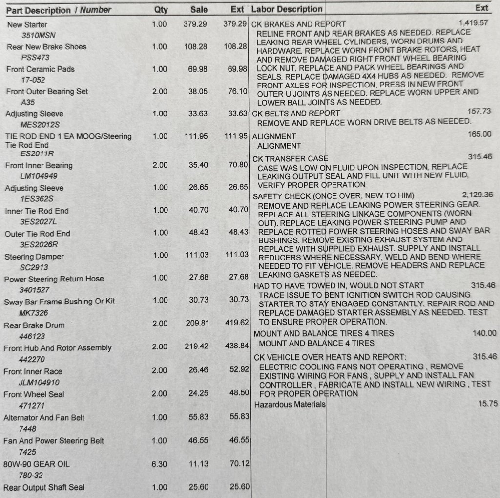

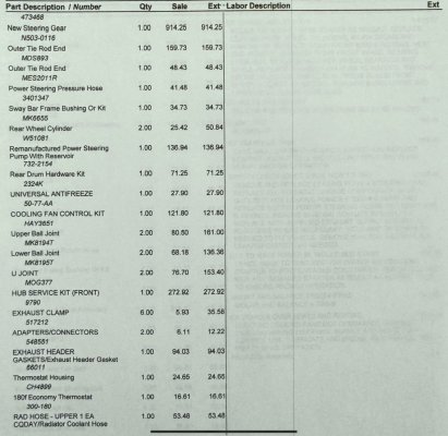

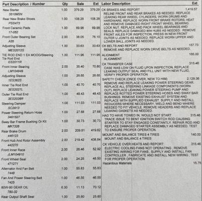

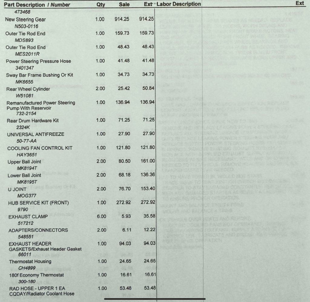

Good morning guys. I got the truck back and it is running well after a number of fixes. New issue that has come up and I am hoping that you might be able to lend some advice and comments. The truck has 35x12.5 R15 tires on it. They replaced the steering gear with a New Advantage Steering Gear Box N503-0116 which I was hoping would help the steering looseness. Long story short It Did Not. When I had it up to 65 mph the thing was a major handful. Literally back and forth all over the lane. In the research I have done the most common recommendation has been to add a cross over steering kit. My understanding is that this would require at a minimum a new passenger side knuckle and that means pulling the hubs, breaks, bearings. I have watched a 100 instruction videos on this but I guess what I am asking is how realistic is it for me to consider doing this myself. I can follow instructions but candidly I have done almost no mechanical work on a vehicle. I would love to be able to do these types of repairs/replacements to the truck going forward.
Any thoughts or advice would be greatly appreciative. I will post the overall work order for the repairs completed to this point.
