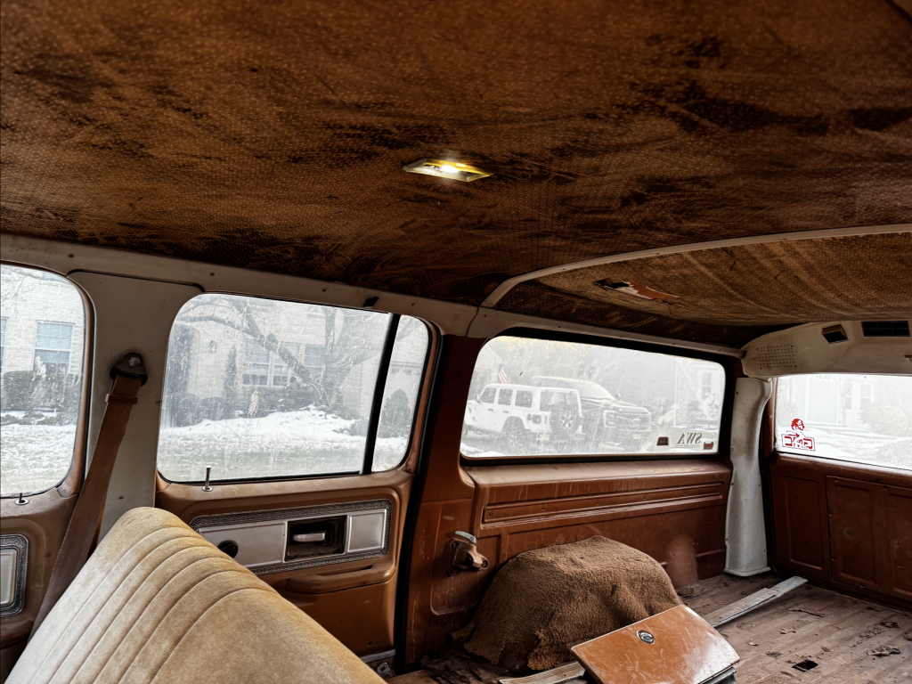

On another note, could you tell me what the actual GM color of the headliner is? My research leads me to believe that it is "Mystic." Does that make sense, or does anyone have other thoughts?

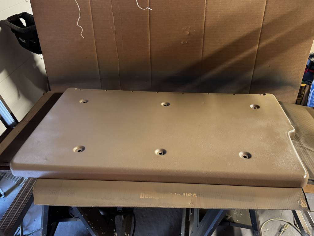

Sorry it has been so long since I have posted any updates. As I said last time I was having the Burb towed to a shop to have them complete what they were calling a “safety check” (basically a once over to let me know where I stood with the overall condition). If you remember it would not start and although I was pretty sure it was the starter I was leaving for a work trip and didn’t have time to try to confirm that and/or try to fix that myself. Admittedly apart from normal oil changes I have never really done any work on my cars. This is something I want to change and I am looking forward to learning how to do many of the needed repairs and future “upgrades” myself. With all that said I still don’t have the actual truck back yet. They probably didn’t look at it for about two weeks (frustrating) but I was away for work so not the end of the world. Once he did he called me with a laundry list of things that needed to be done however despite me trying to write them down as he was talking I know I missed a bunch of them. When he gives me the itemized list I will share it and get your opinions on what has been done and what you guys might recommend as next logical steps. With respect to the actual work on the Burb I have been watching as many YouTube videos as I can find on job like upgrading front disk brakes and swapping out the rear drum breaks for disks. That has proven educational but I guess until you actually try to physically do something you don’t really know if you can. Any suggestions on the best way to educate myself on Square body repairs would also be greatly appreciated.

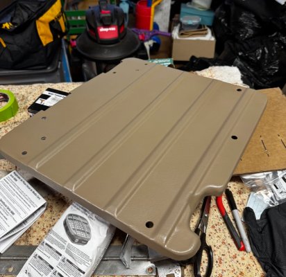

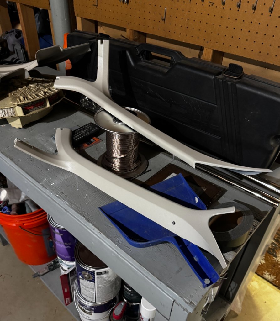

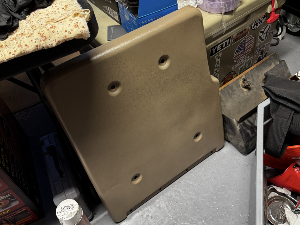

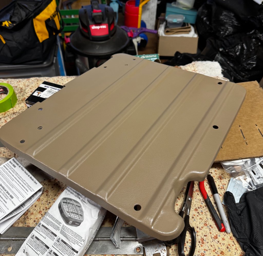

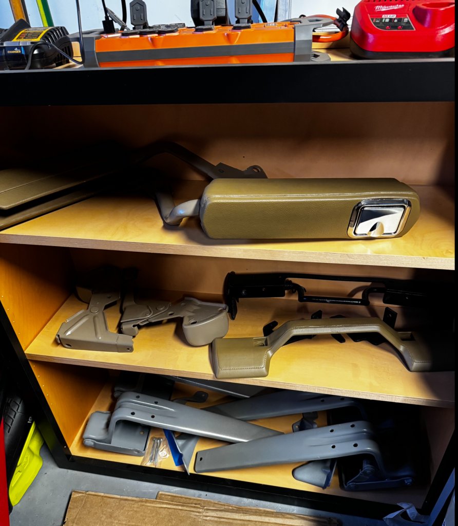

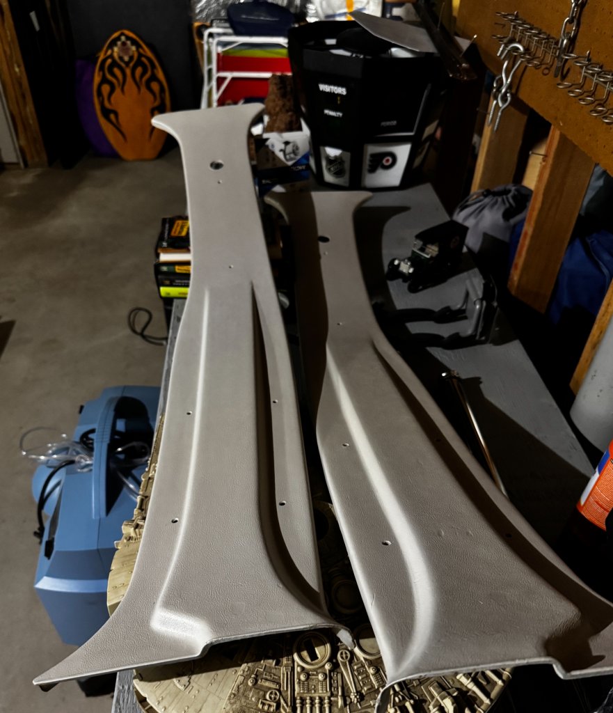

I have been working on the simple things that I can figure out myself while I am waiting for the truck to come back. Things like tearing the seats out sanding and repainting them. Cleaning and repaint the interior trim pieces. Frankly things that I can’t really mess up but give me something to do while I wait. They are all window dressing items and don’t really impact the more important things like how the truck actually runs and functions but it is stuff that at the moment I can figure out on my own.
Ultimately my goal is to get this one as close to my Dad’s original as I can while learning how to do as much as I can for the future. I have three grandsons and between myself and their other grandfather (who is an absolute paint and body shop expert) I would love to be able to gain enough knowledge so that he the grandsons and I can someday buy restore and get them all up and enjoying their own Square body body trucks.
Sorry for rambling. I’ll post some pick of the stuff I have been doing since my last post.

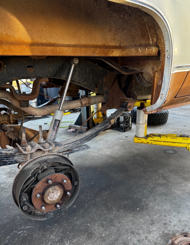

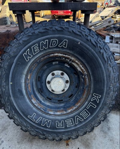

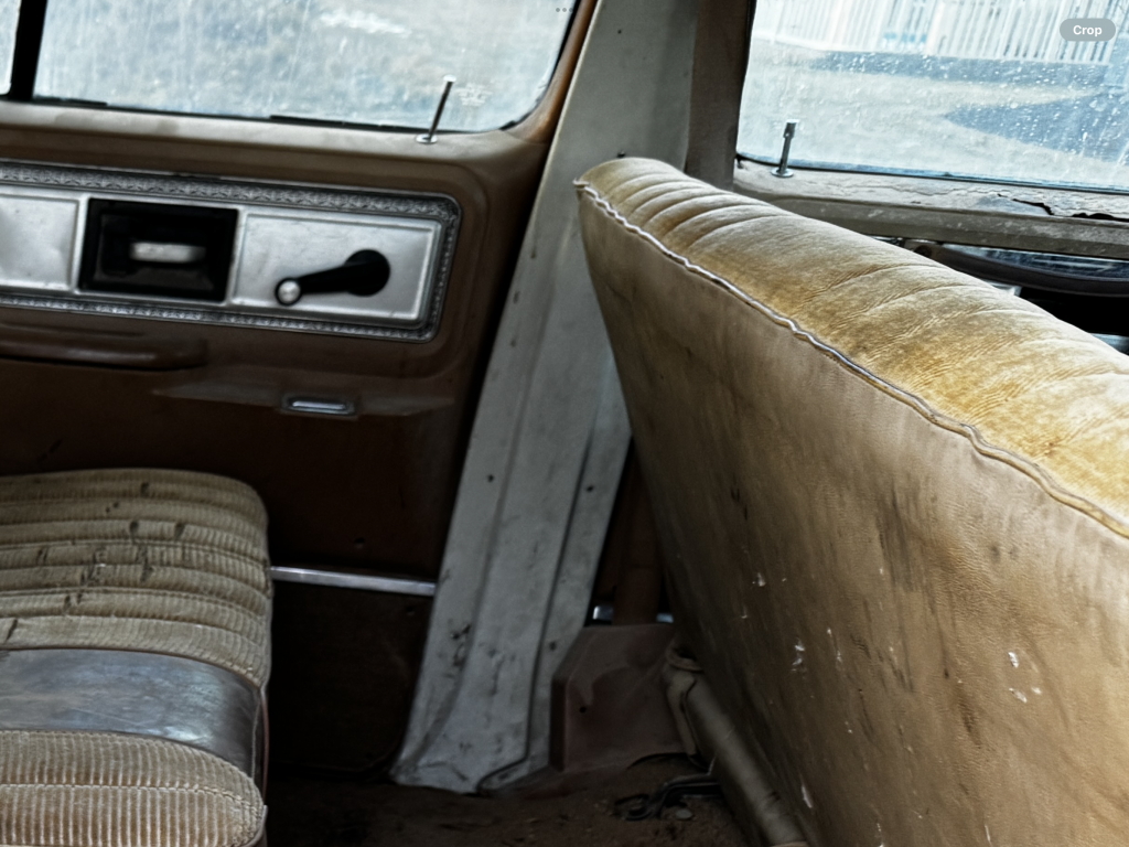

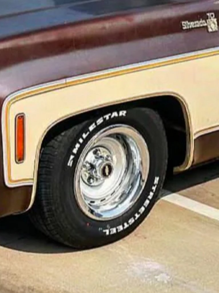

A few more pics and also one more question. I have been looking at replacing the wheels on this truck at some point with some white wagon wheels and the question that keeps coming up is what offset do I need. The truck has what I am pretty sure is at least a 4 inch rough country lift on it and at the moment has 33x12.5r15 tires on it. (I’ll post some pics of them as well. Any advice on offset.

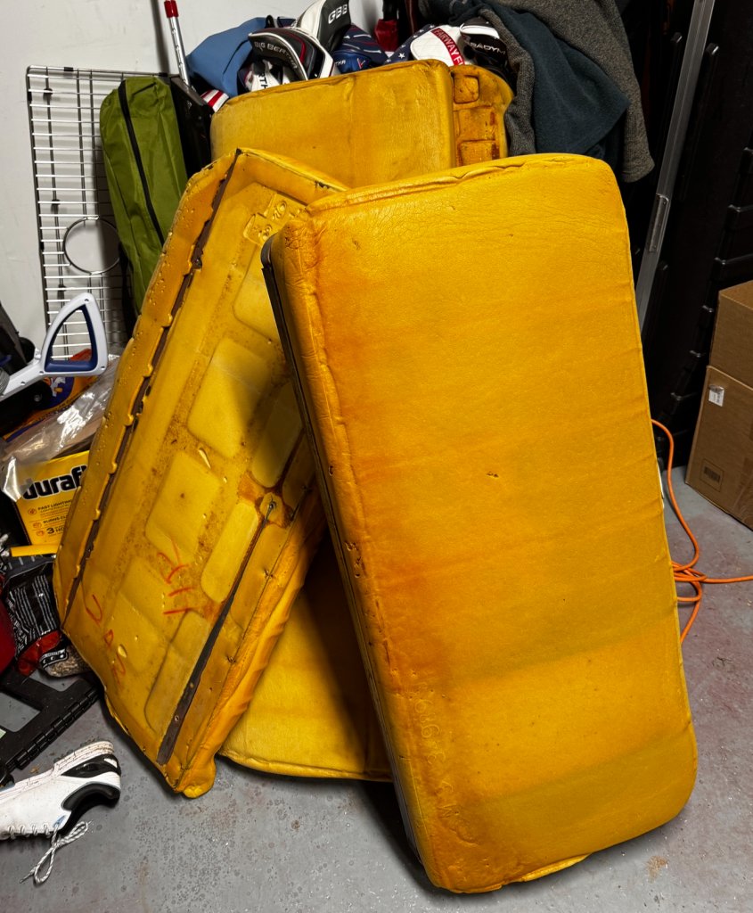

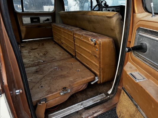

Seats and interior trim pieces

Your stock wheels are zero offset, or about 4" backspacing. If you go with a wider wheel, you will want to stick to right around 4" backspacing.

And yeah, that looks to be a 4" lift.
The more I looked at them they seem to be 10 slot rally wheels. I am think I will just get that black paint off them repaint them with some Eastwood silver wheel paint add some rims and 4x4 hubs and call it a day.
